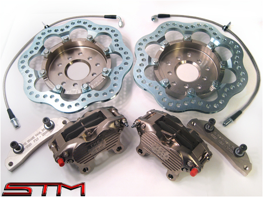

    We use a form of cross drilled in drag racing, it make for a very lightweight setup, but very pricey.
    The rotor/caliper/lines/hardware together weigh well under 20 pounds.
    One hard stop isn't quite the same as multiple hard stops That setup is friggin nice though man, even if it's only drag racing, hehe. Gonna throw some on the Stealth, or did I not see them?

    We actually have a couple cars around here that daily drive wiith those brakes. The loss of rotating mass really helps to.
