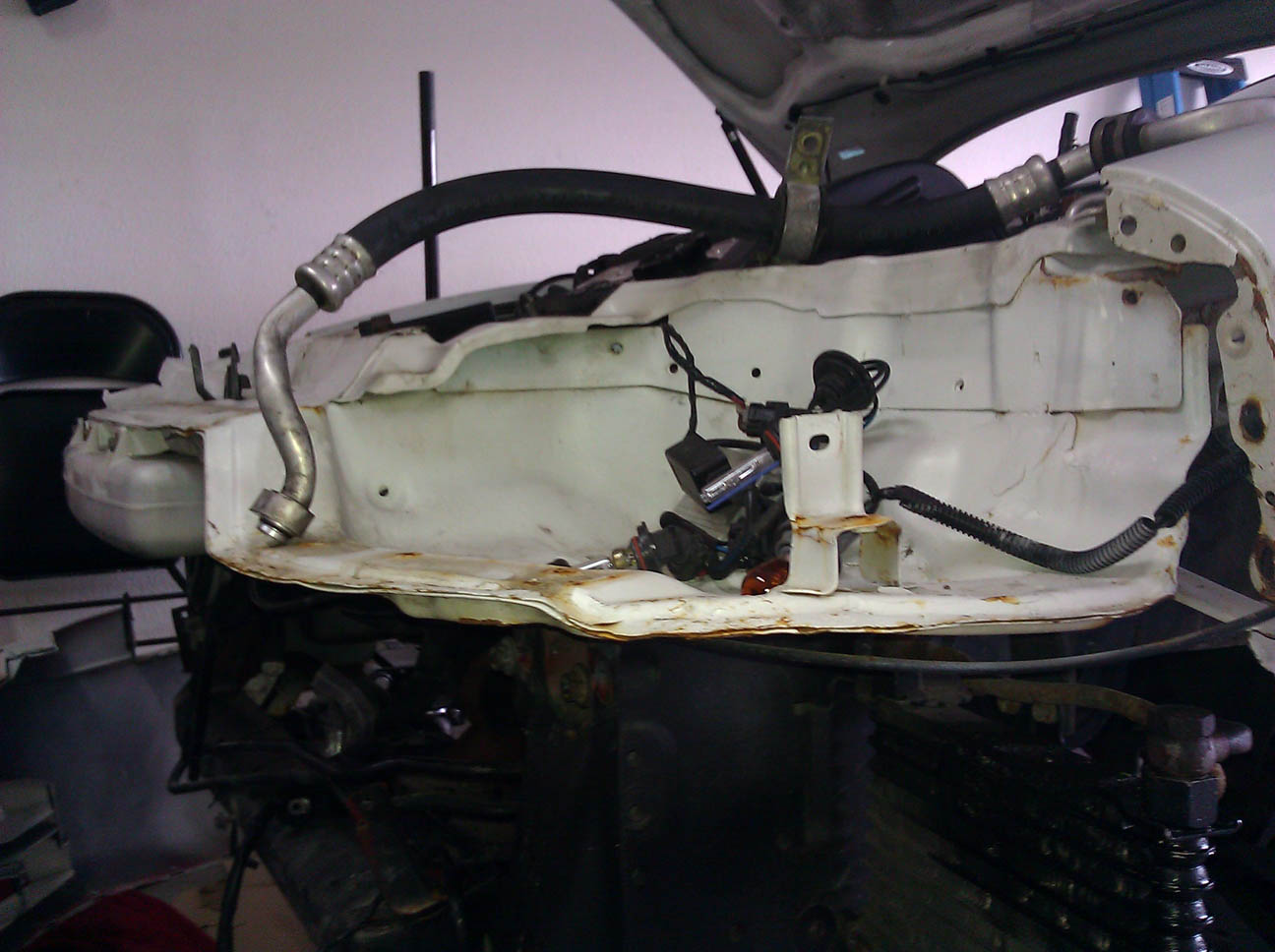

    Started to tear apart the car today. Body lines will be a bit more work to fix that I had first thought, but should go smoothly.

    At least now everything is torn down and jacked up so I can get some real work done during the week.

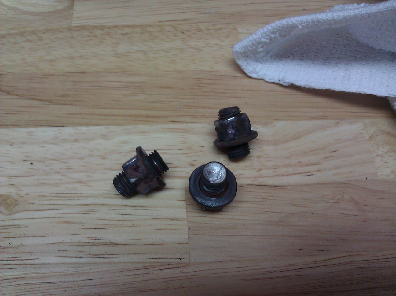

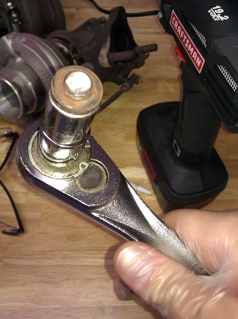

    The first of many for the day.
    I think there were 4 total that snapped. All of them on the turbo housings, They all came loose and almost to the end yet they decided to snap. Not even a healthy amount of PB blaster could save them.

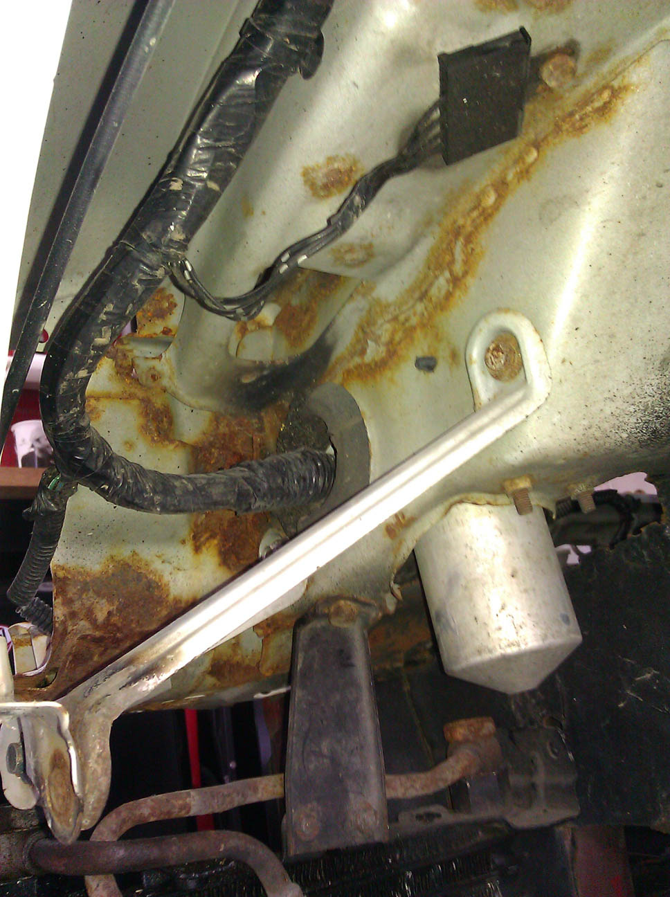

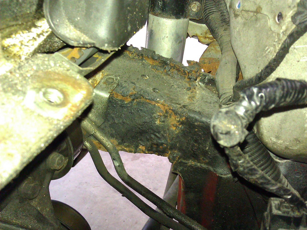

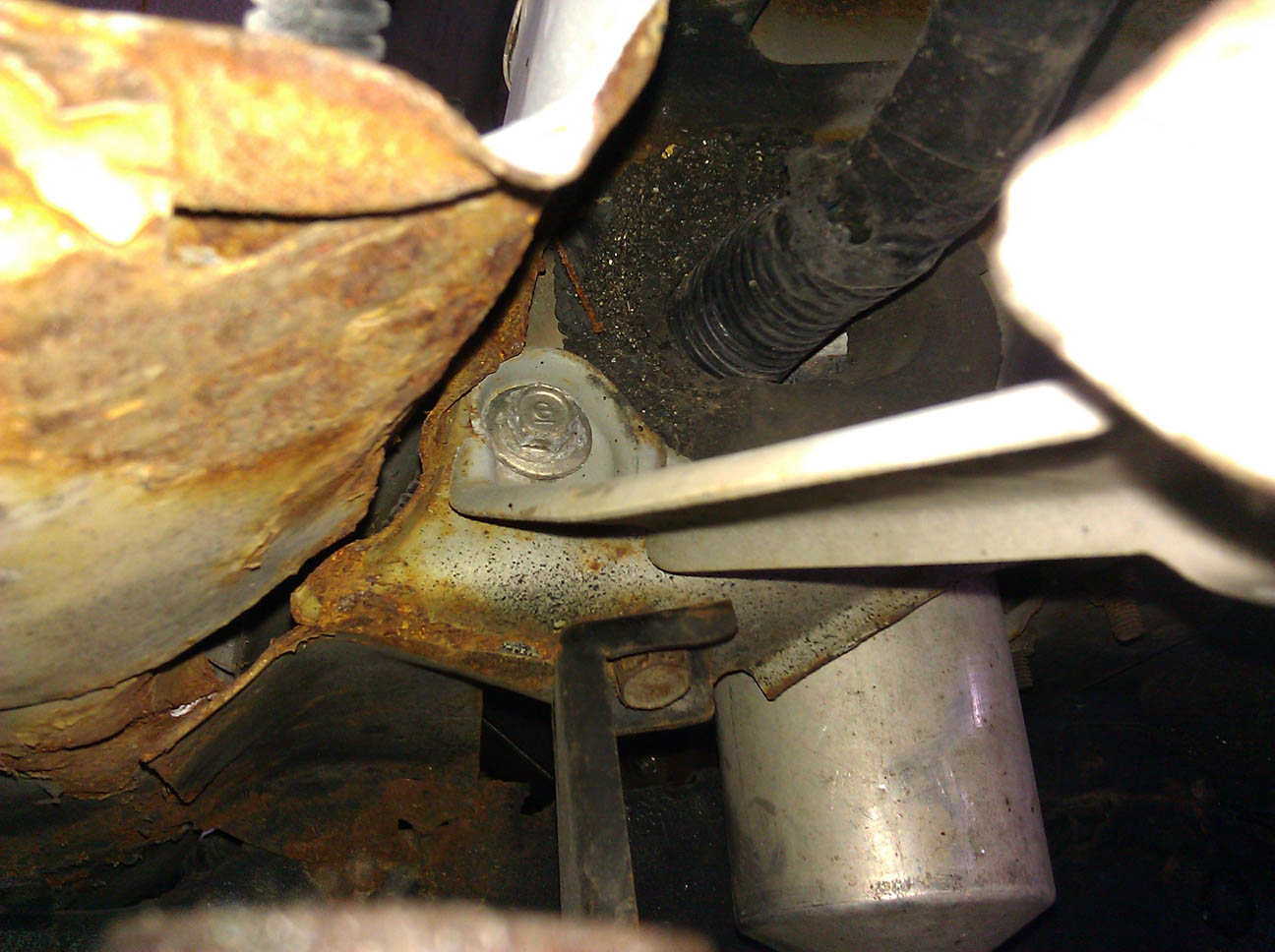

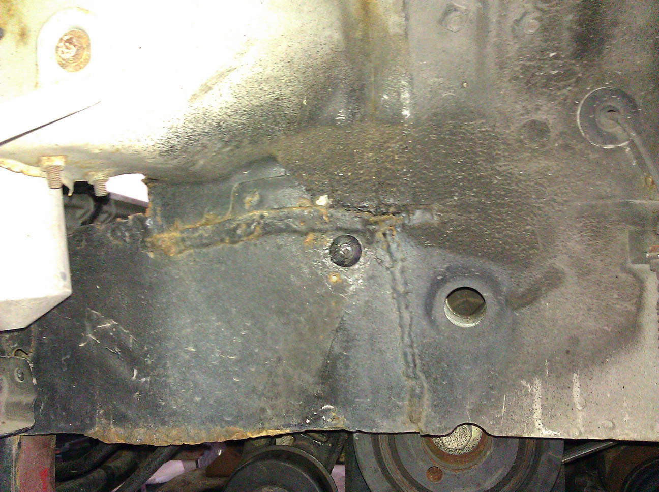

    Now for the fun pictures. The frame damage on this car is horrible. Or should I say the repair on the original frame damage on the car is horrible. Just to be clear, GZP did not do the frame repair.
    I ordered up a new headlight bucket and lower radiator support, most of the other stuff should be salvageable. (hopefully) But will all need to be brushed clean, primed and hit with some paint to seal it properly.

    ouch you hate to see that. I am sure you will fix it properly.

    Thanks! Yeah, the car was originally from Ohio, then bought at an auction after she was totaled. So I'm willing to bet the bulk of the rust is from when she sat in the winter she crashed.
    When I bought the car, I was ready for rust. But from only ever working on southern cars, I'm still floored the more and more I dig into her.
    That's the plan. Fix her up, brush, treat and spray all of the rusted spots.
    I need to make a big ACE hardware run and get all nice new bolts in a number of areas on the car. She will be awesome once she is done.
    Not looking forward to drilling out the broken stud. Thankfully I only have to drill out one.
    561
    22
    Thanked 15 Times in 13 Posts
    get a good drill bit and it will melt right through anything you tell it to cut through.
    as a mechanic who has gone through 10s upon 10s of drill bits - you can DEFINITELY tell the $10 bits from the $80 bits.
