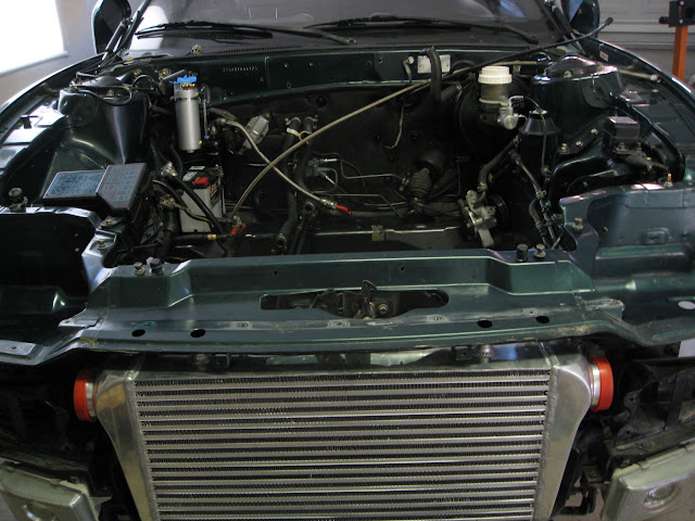

    I love my small deka battery mounted where stock windshield washer reservoir should be. Dropped ~30lbs, lowered the weight, and dramatically cleaned up the engine bay. No extra wiring. Obviously, not a good idea if you have a big stereo. If car sits more than a week or two, a battery tender is probably a good idea as well. Otherwise, it starts the car without fuss.
    You could probably mount a full size battery down there also. BTW, I ran a line from rear washer reservoir to front washer nozzles. Haven't actually tried it yet to see if pump has enough to get the fluid to front

    Quote Originally Posted by familyMAN View Post
    That's nice and clean, I can't really do the small battery thing though. My car is still a near-DD, I leave it at the airport sometimes, etc.
