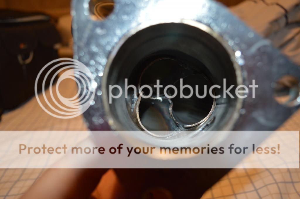

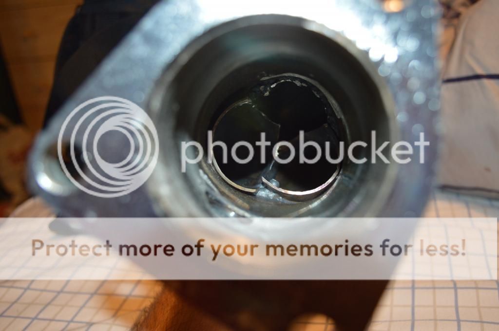

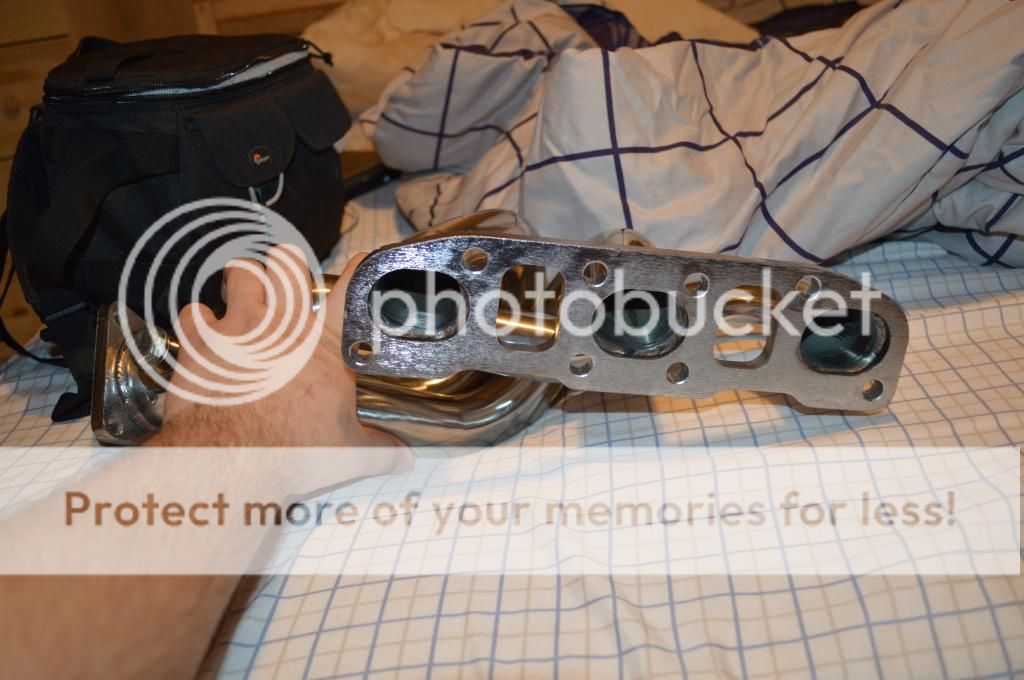

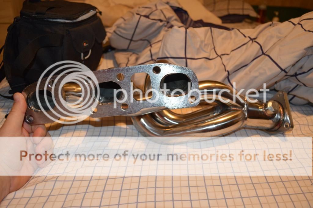

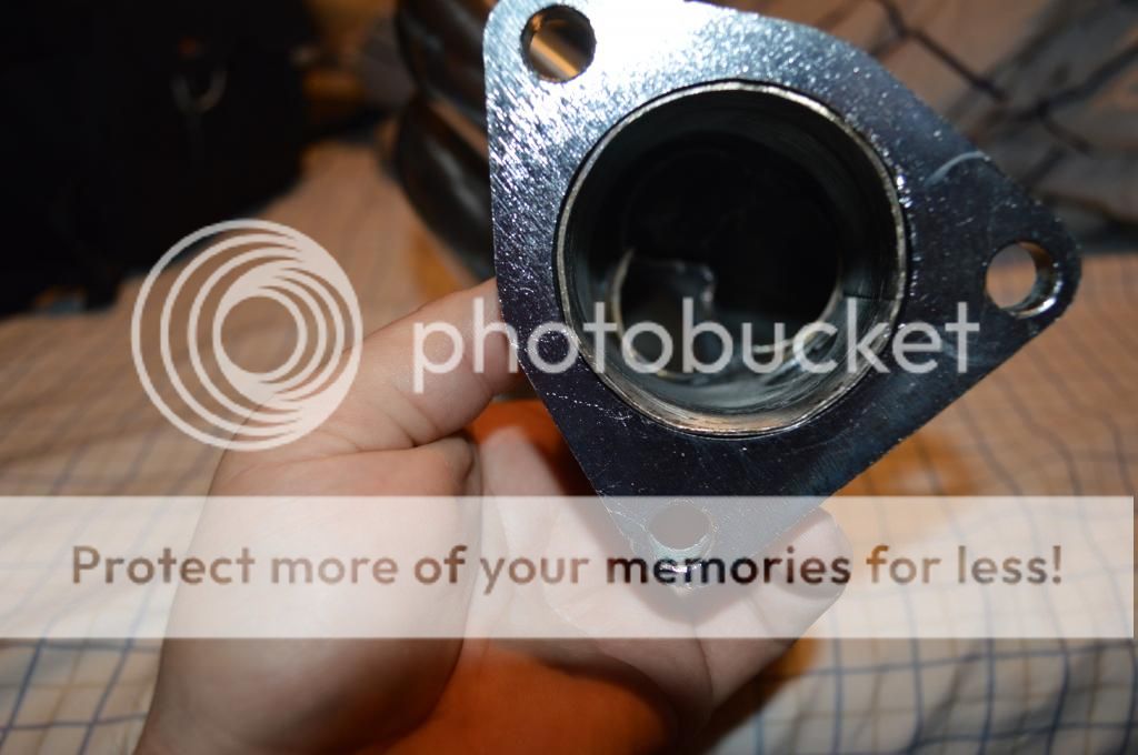

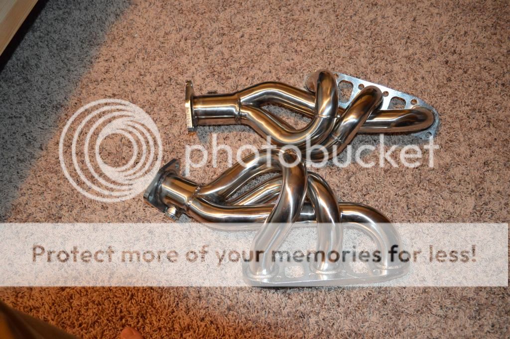

    Well I received the 350z manifolds and for the most part for 89 dollars I can't really knock the quality too much... I mean the collector wasn't skillfully made well, but I applaud their effort. It's a good starting point:

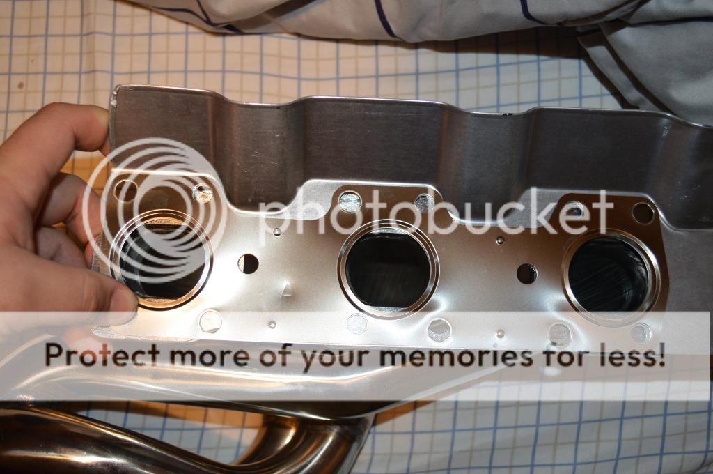

    Here's the SOHC gasket lined up with exhaust ports of this manifold (gasket is on backwards, but even flipped, runners still line up):
    The runners would need to be made round again, but nothing major.

  6. #216
    How thick is the material on there?
  7. #217
    wow those are shitty inside. I would do some porting to be sure you aren't going to have chunks of pipe go through your turbo
  8. #218
    I don't own a VR4! Not Verified
    Andover, MN
    529
    Thanked 19 Times in 17 Posts
    Quote Originally Posted by mb3000 View Post
    304 SS
    They are shitty inside, I will either A. Redo the collector or B. have the material ground down so it isn't so ugly.
  9. #219
    304 SS is what they are made of. Is there any way you could stick a caliper on there when you cut off the 350z flange?
  10. #220
    Andover, MN
    529
    They are 16 gauge from my understanding.
