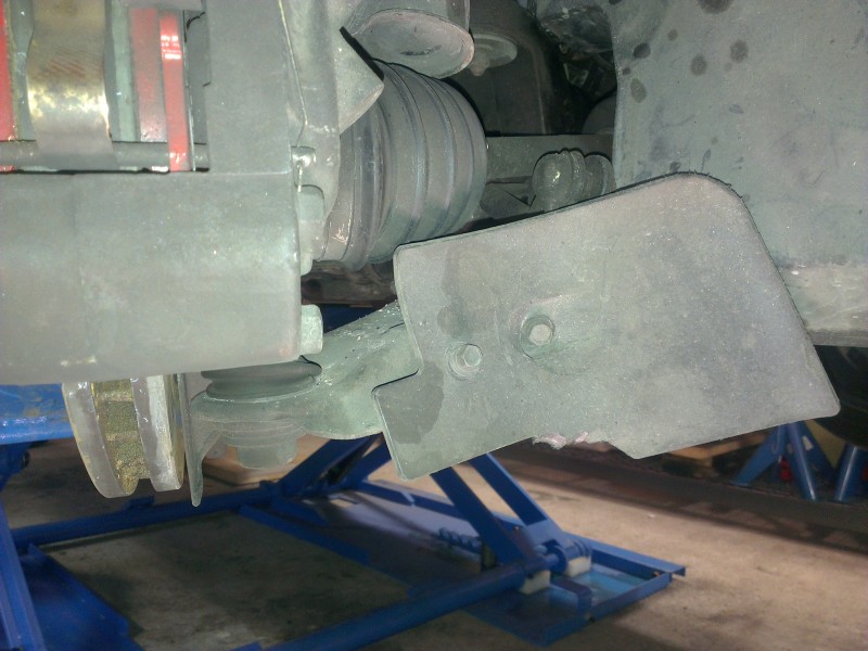

    I bought these from Hans.
    They are from the MR's. See the 2nd mounting hole? MR control arms had a 2nd bracket.
    They seem to work, I haven't had a previous sifting setup but my last track event in March (rain, temp in the 50's, the front calipers were only 150 degrees after a cooldown lap where the rears were 250+.
    We can test them at NG, a few other guys have the same front brakes as me, I will bring my IR gun.
    From the phone.
    Came across this thread last night so while spending some time in the garage I took photo with my phone.
    Here is how they are mounted on the MR and Eurospec cars using both bolt holes:

    Hmmmmm, that looks simple enough to fabricate- are there provisions to install something similar on the rear control arms? I havent looked back at mine too closely before i put it in storage for winter
