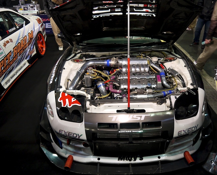

    that opening on your front bumper is so small. i have never seen a turbo car with such small opening that races at the track. if you want to solve the problem then you should look in to pit road m GTO's . well over 850hp and racing 3-4 hours of race with no over heating issue. are you using straight water? maybe you should add some water wetter.
    it looks like they are using two tanks here.
    what they use is their IC. how does your IC flow? that's very important. also they use radiator breather tank which catches all the air bubbles in your cooling system.
    EXTREME PSI : Your #1 Source for In Stock Performance Parts
    can't post the direct link but here is the pictures on their site. go to original parts then cooling parts.
    http://www.pitroadm.com/public/newframe3.htm
    but if you could make your ic setup like this would be the best of both world.
    this is interesting. radiator and ic both are tilted to make it fit. you may be able to do that on the front bumper area with such long nose we have.
    or you could go crazy and mount your radiator on the back.
    http://blog.bespokeventures.com/tag/...nted-radiator/
