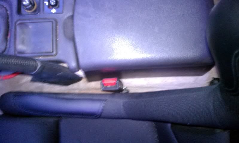

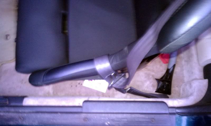

    This is mine, you can see I just run the stock seat belt. Theres no need for a harness if you don't have a rollcage, you could get squished in a rollover.

    Goallie...do your seats slide back and forth? Also, how did you mount the receiver for the belt...to the seat or the floor? I wanna be safe so I can see my 2 kids grow up

    They do, I am using the Corbeau brackets which is why I highly recommend against them... not for the sliding but because they suck.
    For the receiver I just turned it around from the stock position, really the only way it would fit, bolted it back in and wala works perfectly.

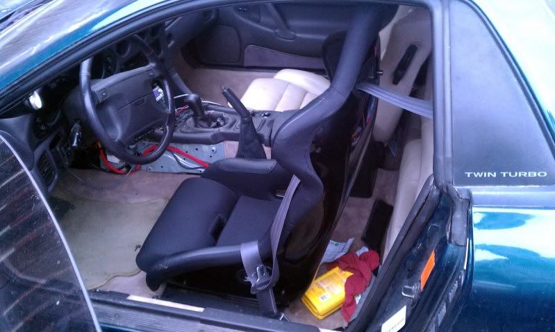

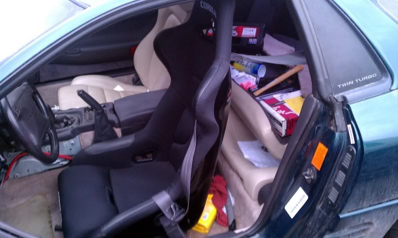

    i used a kirky seat, custom fabbed the braces i got from jfast to fit a set of stock sliders and perfect fit and they slide. bloted the seat buckle to th ealuminum seat and its perfect. have to wiggle out being 6'1 235. heres some pics
