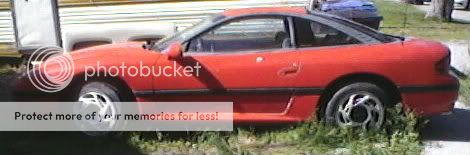

    I was wondering about the SOHC versions, so thanks for warning me away.
    Here's my "new" ride:
