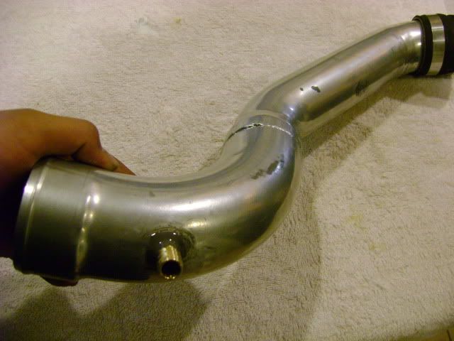

    Hi
    I am fitting a pair of dejon intakes, i have taken off the oem stuff and the maf, the issue i have is my dejon pipes have no conections for the vent pipe from the rear rocker or from the other pipe (i dont know what this does) :? What do i do with these pipes i have an AIT and a MAP fitted as running a AEM EMS
    i have looked online to find some fitting instructions but nothing
    Any help please
    Nick

    The front is for the EVAP/purge valve. I simply added my own 3/8" hose barb fitting a long while ago. This allows me to continue using my second OCC+KV.

    hmm, I bought the Dejon ones specifically because it didn't have those. I will say that the craftsmanship isn't the best (I'm sure you see the weird vice marks on the side) and I wouldn't buy anything else from them..
