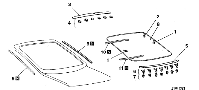

    I'm looking for the following that I can't seem to find the right page in CAPS.
    #1 and #2 ( including both white and yellow clips)
    #3 and #4

    #1 - MR704491
    #2 - MB645305 (white)
    #2 - MR108975 (yellow)
    #3 - MB641211 (includes clips)
    #4 - MB417673

    Not all what I was looking for but between you and 3si I was able to get the correct list! Much appreciated.
    MB645305 tailgate clip white
    MB645169 tailgate molding
    MB645305 windshield clip white
    MR108975 Windshield clip yellow
    MB976400 Lamp black molding (your number was for red)
