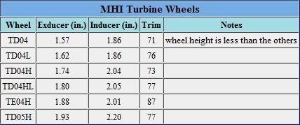

    According to Stealth316. So looks like there is quite a difference.
    MHI Turbine Wheels
    Wheel Exducer (in.) Inducer (in.) Trim
    TD04 1.57 1.86 71
    TD04L 1.62 1.86 76
    TD04H 1.74 2.04 73
    TD04HL 1.80 2.05 77
    TE04H 1.88 2.01 87
    TD05H 1.93 2.20 77
    Edit: sorry forum won't hold the formatting. it seems to delete the spaces and bunches everything together.
    Edit2: photobucket'd

    You got it backwards. L wheels are smaller giving faster spool with less total power potential and the HL's are larger giving slower spool and more power potential.
    If it is a 19T that refers to the compressor(intake) wheel. The L and HL distinction is for the turbine(exhaust) wheel.
    Jeff
    Oh ok my mistake.
