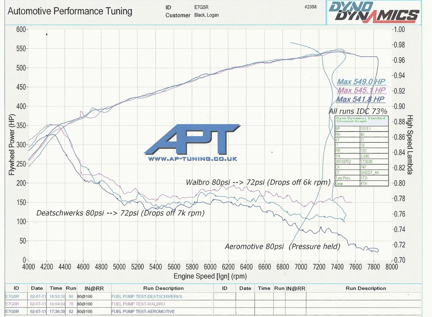

    I seem to recall seeing a thread on the other site with flow data comparison to stock and denso (supra)

    its on here too

    The aeromotive pump is silent and 149
    ...and moves more than the other two, cheaper than the other two, and TOTALLY silent
