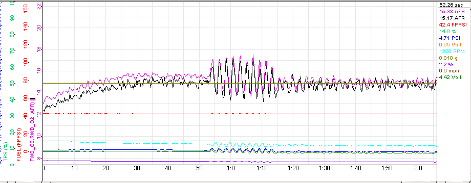

    Well I noticed something interesting today. I was logging when starting up and noticed that it started off with the front and rear different. Then when the o2s starting cycling they came together. Is is possible that something is up when in open loop? Can I force open loop in other ways than cold startup and WOT?

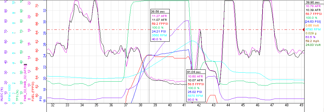

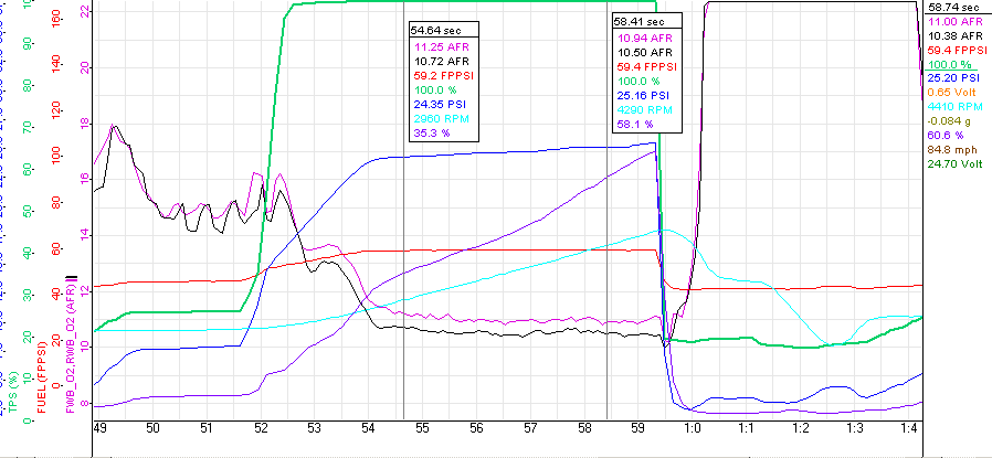

    Here is a 3rd gear wot log

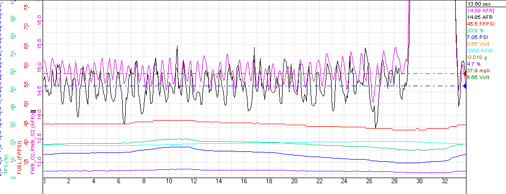

    Here is a cruise, the guide lines represent the smoothed average. So yea, the rear (pink) is leaner.

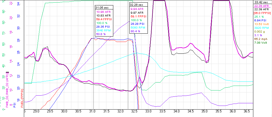

    Here is a wot with boost and fuel pressure in focus. The scales aren't quite the same but there is something interesting. Boost goes up .81 PSI but fuel pressure actually went down .7psi, so fuel pressure is off by 1.5psi. Not sure if that is anything significant. I would imagine this isn't exactly a big deal as both the front and rear would experience this?

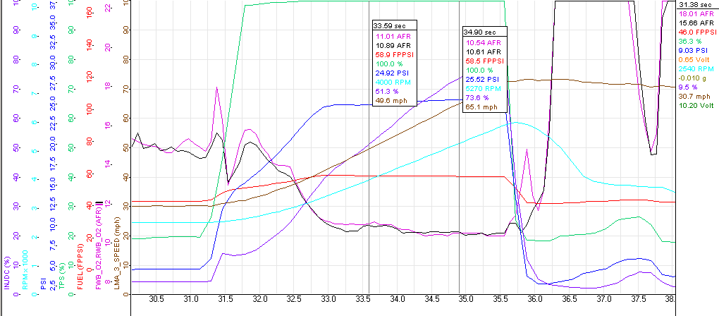

    This is a log of after I fixed my aem afpr last summer. I had a similar issue where the rear was running real lean and as it turned out the afpr was leaking because of a worn ball seat and dropping fuel pressure to the rear. You can see how nice this log is (except for the tune of course)
