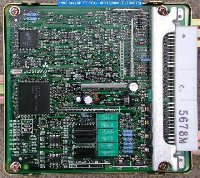

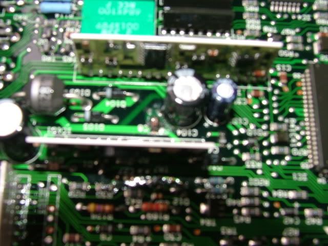

    Here is my ECU with the leaking cap. It's hard to see it so I found a pic on the net and circled the spot in red. See pic below this one.
    You might be able to see this better. The red shows how far it leaked out.
    What is that rectangle thing the cap leaked on? a transistor? It's labeled C6
    I'm wondering if the cap leaking on it and screwing it up is the problem instead of the leaking cap itself.

    That's a surface mount capacitor. It could only screw it up if it ate part of the trace on the board.
