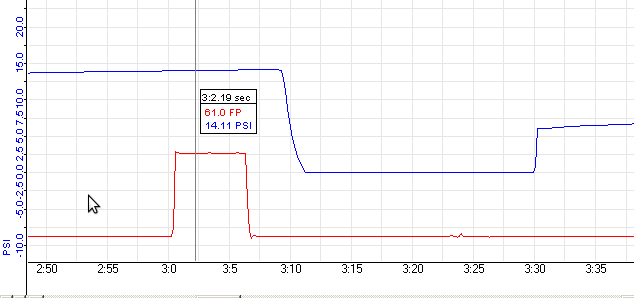

    Did some testing today...

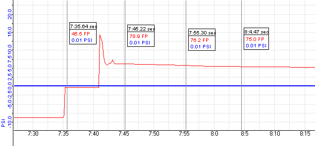

    First checked the fuel system to see if it will hold pressure to make sure the pump oring is sound. It was kinda tough because my aem afpr loses pressure immediately. Has always been like that even after swapping orifices and diaphragm. I hear this is common. I ended up clamping the return line and blipping the pump.
    Seems good here. Takes a long time for the pressure to drop off.

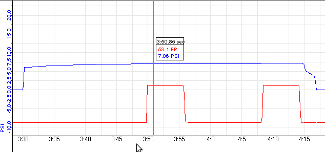

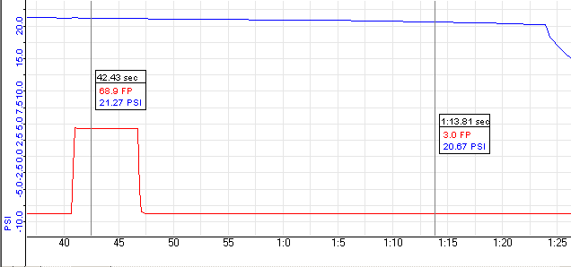

    Then I checked the regulator's operation at different psi. I used the same boost line to the regulator to my regulated compressor. Here are some boost levels:
    (boost sloping is from my compressor's regulator, takes a while for it to get steady unless I put a lot of load on it)
    I did the same tests before and after swapping the regulator diaphragm and there was no difference. Obviously this is not a real world test since there are no injector "leaks", battery voltage only, and the car is off. This is on a cold car as well.
    Tomorrow I'm going to do some more tests and see what happens after the pump has been running for a while. I also plan to rig a voltage tester so I can log it while driving. I will figure this shit out!

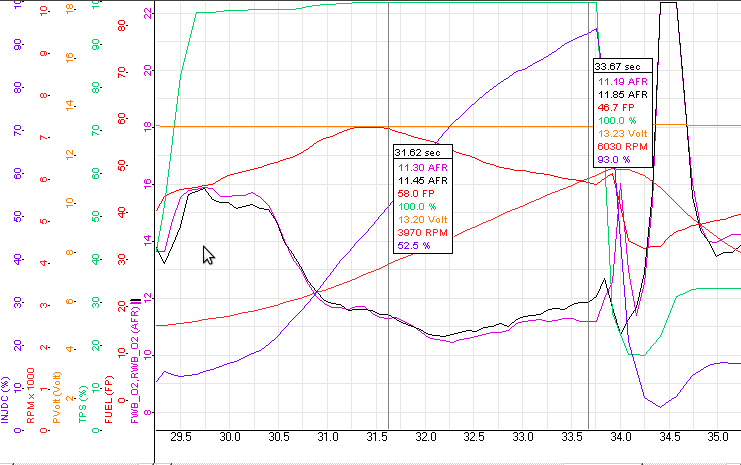

    Alright did some more things. I removed the left over stock wire (5") going to the fuel hat. I pried the terminal apart and soldered my 10awg wire directly to it. Tested with meter and there is "no" resistance measured. I also removed the ground log and grinded it down and added my own 10awg ground. Wiring should be solid now. I also added 16awg jumper wires to my logger to log voltage. I adjusted for voltage drop with my added test leads.
    Here is the log. I forgot to hook up my boost sensor after testing the regulator but my gauges peaked at 14.5psi.
    I extended the left scale (I usually forget) for the legend.
    Voltage does not drop. However, when I logged the voltage on mmcd/palm, it drops to 12.5 from 13.6. That's weird... Is that common?
    So at this point in summary:
    I have solid 10awg hot wiring to the pump
    new fuel pump (walbro 255)
    new fuel filter
    new afpr regulator
    voltage at pump does not change
    pump oring holds 75psi+
    One thing I thought about is maybe it's something right from the start. The filter on the end of the pump. It looks a little grey. Maybe I got a tank of shitty ass gas and it is the one that is clogged? Cheap enough to replace I might as well do it anyway.
