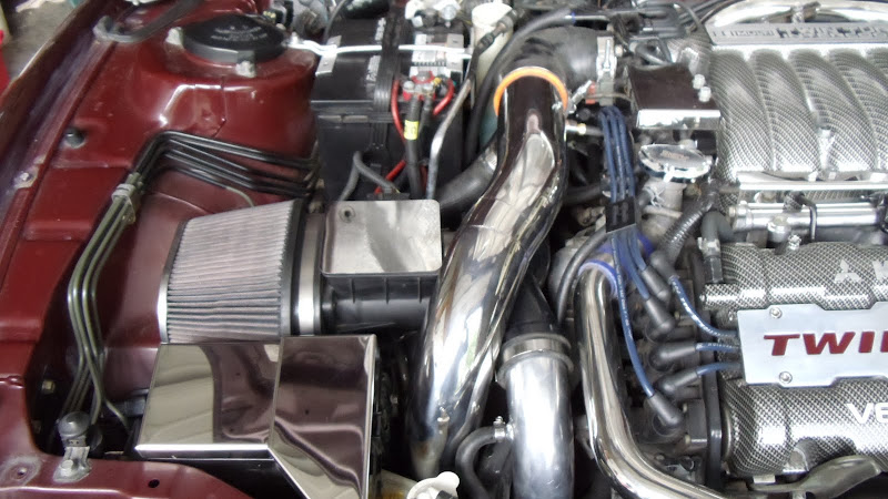

    Test fit to get an idea of how much of the upper shroud will be chopped.
    Time to whack the painted side mounts, finally.
    One of five test fits for the T/B pipe. This thing was a real bitch to get right.
    After getting it right, I realized with a phone call from Brett (VR4Tune) that apart it comes again to cut the weight off the shifter cables to clear.
    Side shot after getting it right.
    Finally, it's in there and plumbed!
    Had to add a hanger so the damn fat pipe would clear the shifter.

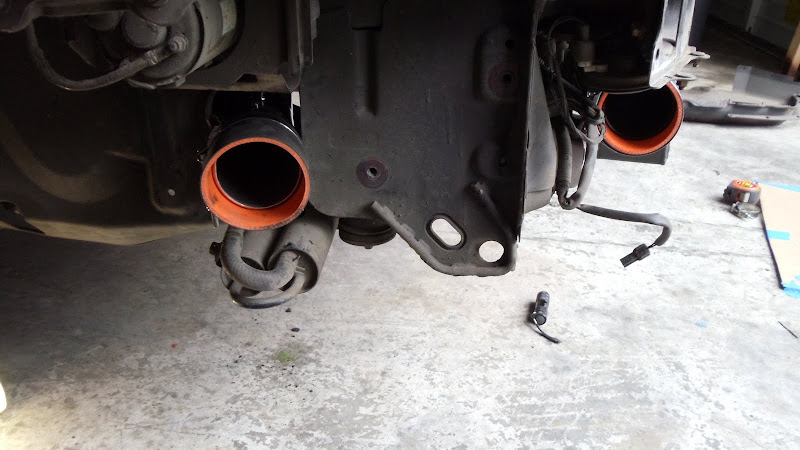

    Front turb pipe down and out of the heat of the headers.
    Another T/B side shot.
    Drivers side. ETS uses the stock rear turbo piping, but I had the DNP one that matches nicely.

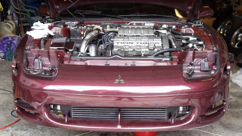

    I had to see it with the bumper cover on. Not mounted due to I am making a less monstrous crash bar to flow air better.
    Still have to get the splitter. I have to cut the passenger side fan to clear the piping, but I will post pics when done.
    ETS makes a quality product, well built. The unfortunate part is the pain in the azz that is 3s, and the lack of room to work. No loss of limbs, but I have ripped it apart enough to do it in my sleep...
    sexy.
    i love the all-black. i'm hoping mine looks similar to that (ala lugnut's).
    what size core is that? i'm hoping that if it's the same 36x12x4 that mine is--that the 97 bumper hides the end-tanks better.

    26x12x3.5 Your end tanks should be out to cover the inner clamps in the pic of mine...
    cool beans. i'm hoping for a "stealth FMIC" install when it's said and done.
    keep us posted when you get it finished & buttoned up!
