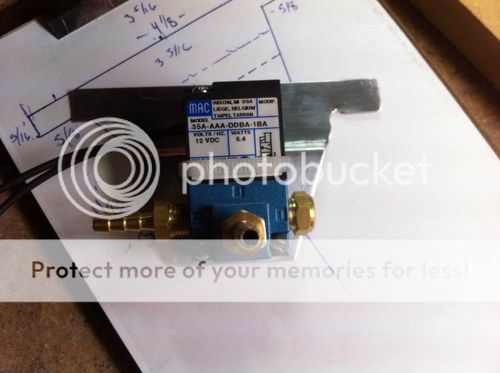

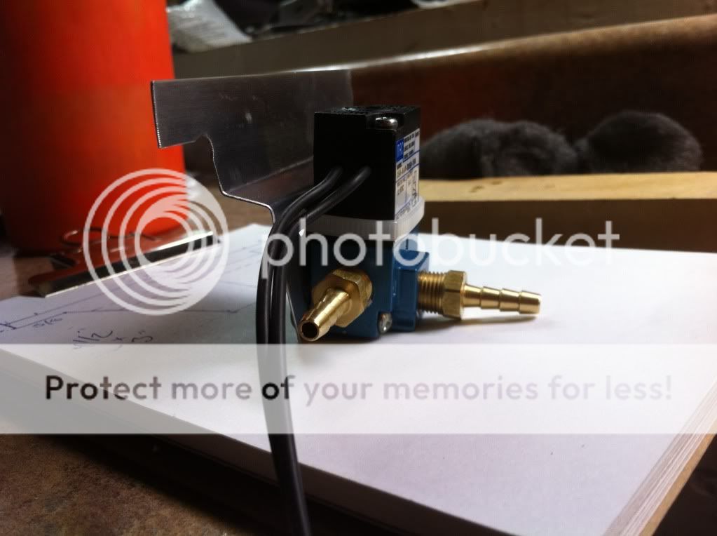

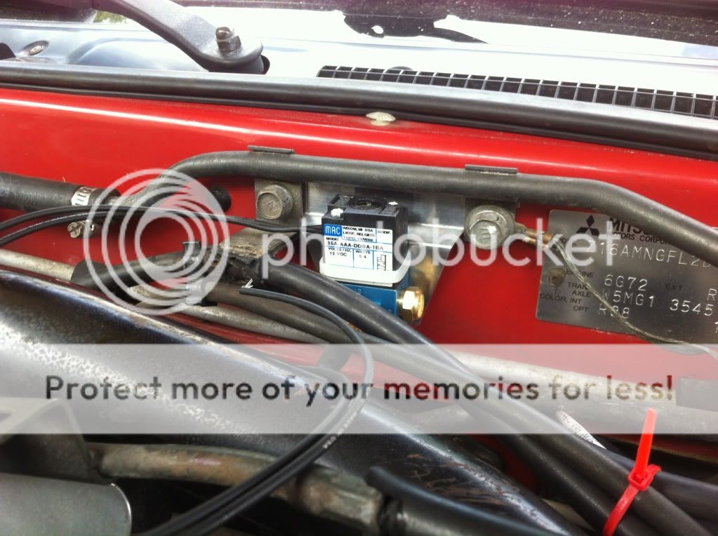

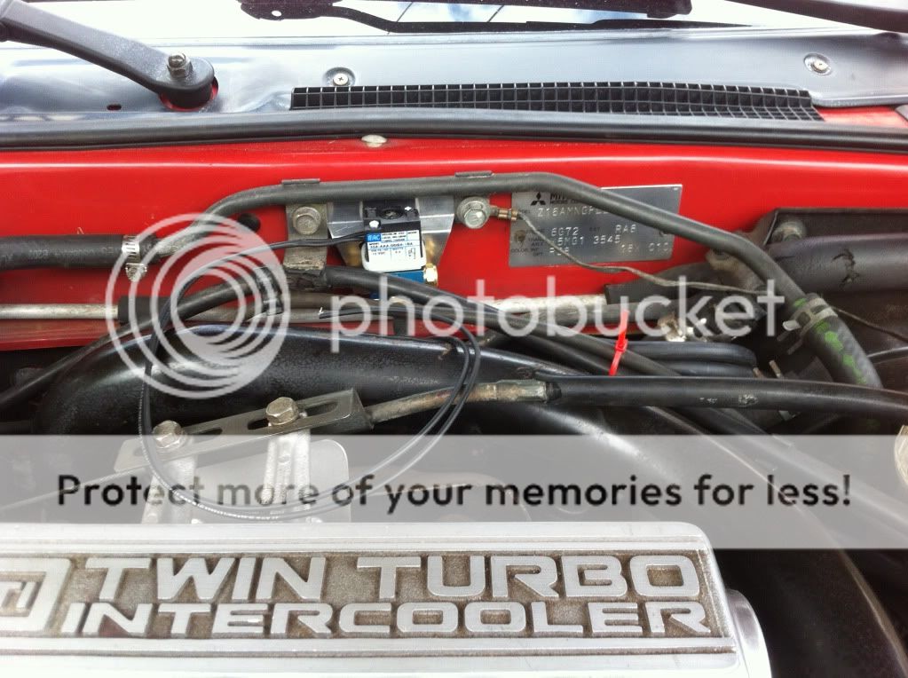

Anyway, pulled vac/signal through the plug near the brake-booster, and the rest of down-and-dirty goes out the window - ten minutes of where-to-put-the-solenoid resulted in a simple bracket:
Aluminum, took about 20 minutes - I also added a soft shoe to the backside of the tang that holds the solenoid.

I like that location
That's better than I did. I just zip tied it to a vacuum tube hard line. Lol. It's on my bucket list to bolt it somewhere.

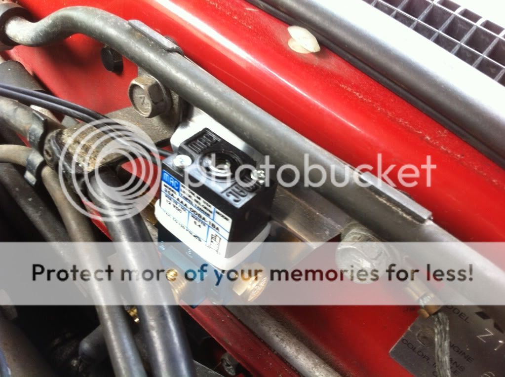

Kev, you might want to put a piece of rubber between the solenoid and the bracket. The noise they make can be annoying. Nice mounting bracket BTW.
Edit: I see some dampeners on the back now. Might still want to put some rubber in between the bracket and solenoid though. Or just wait to see if it bothers you.
