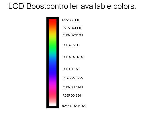

    Newest software feature in v2.16: Custom background LED color. This allows the user to pick a color of their choosing, including amber to match our display.

    Seems like the red matches stock gauges already but I guess I'll load this one and check it out.

    Just made v2.17, it allows you to use the custom LED color as startup color. At the main menu, if you hold down for 0.5 seconds, it will activate some LED special effects. Currently I've made 3 LED effects. Effect 1 cycles Red up and down. Effect 2 cycles Green up and down. Effect 3 cycles Blue up and down. Effect 4 stops at current color. Effect 5 takes you back to your default startup color.
