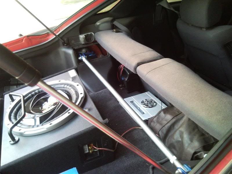

    Once in Cairns I fitted a front and rear strut brace, Ultimate Performance front and Cusco rear. Fitted DBA slotted & crossdrilled rotors on all 4 corner.
