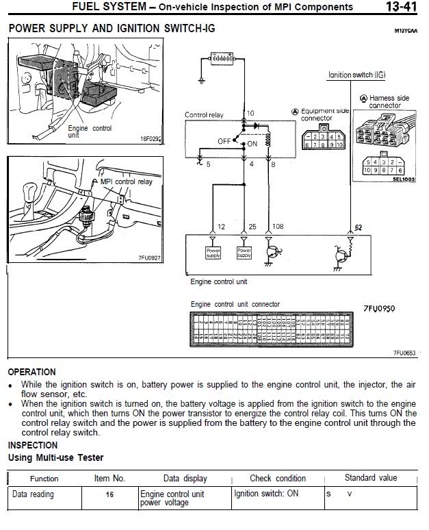

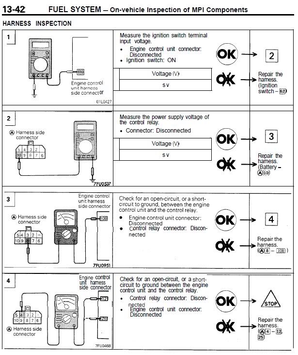

    If that MFI relay is clicking then it's either faulty or the power supply to it is cutting in and out. You need to check the wiring diagram and trace all the wires back. Perhaps the device it recieves it's power from is faulty.
    Well I don't think it is the MFI. I bought two off of ebay to replace my stock one and neither of them change anything. I guess they both could be bad, I emailed the sellers today to ask if they could verify that they came off of a working vehicle.
    Do you know what powers the MFI in the 3000gt? They use the same ECU and MFI so it would be the same. If not I will follow the wire tomorrow.

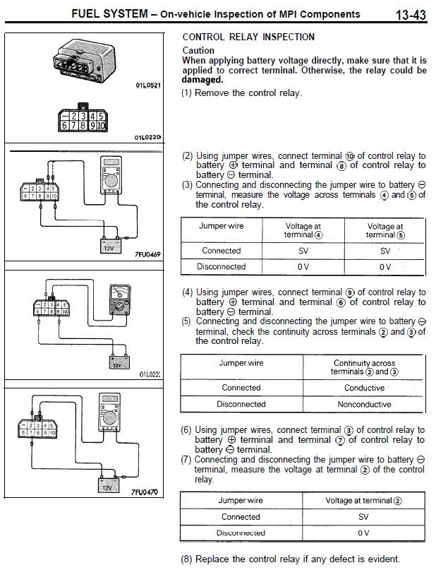

    Interesting, I would take a guess (as you've probably already nutted out) that your + to the relay has a loose connection.
    Do you have a USDM electrical manual like this one?
    I do but it's at my other house right now so I cant look anything up sorry mate, but it'd cover EVERYTHING you need
    1992 1993 1994 1995 MITSUBISHI DIAMANTE SERVICE MANUAL | eBay

    Ok I think this is what your talking about??? The turbo models have 2x relays which might be causing some confusion for you. There is a relay to control the high and low voltage power going to the pump and there is a basic relay that powers the pump. I suspect you on have this one below [the basic only]. This should tell you how to test it and what pins go to where.
    http://www.3sx.com/store/comersus_vi...dProduct=26912
  8. #58
    Thank you!
    Any idea which one I should test for specifically (dont want to screw around with the frail stock wires more than I have to)
