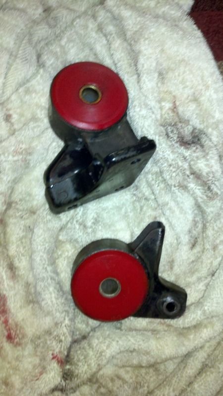

    Got my inserts put in today. Drove 30 mins away to use a local's press. Even with the press this was a pain in the rear because you had to align the inserts juuuuuuuust right for them to go in.
  2. #472
    I installed the motor mounts today. Hooray!
    The throttle body shaft seals I ordered from Aby @ Mil.Spec did not fit my 1G DSM throttle body. I have no idea how anyone else gets these to fit. I ended up screwing both of the seals up trying to get them to seat properly but neither would go in.
    Should have listened to my gut when it told me to order the STM ones...
  3. #473
    05
    iowa
    543
    111
    Thanked 45 Times in 37 Posts
    those mounts look familiar my mounts were easy to put in because they dont make em for awd auto .... so had to get a sleee made that i put over the poly then press fit the sleeve and poly and all into the mount
