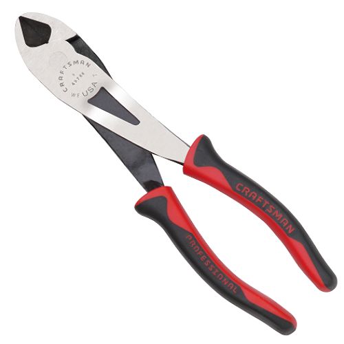

    I use this to cut all of my lines:
  10. #250
    Actually shears are the last thing I'd recommend someone use to cut SS lines. They fray the lines like crazy and you'll never get a clean cut like with a cutoff wheel or chisel. I tried it one time and was not impressed at all with the results.
