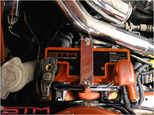

    Sorry for not noticing this sooner, this is the kit that was mentioned. Pictures are of the first tray i made, they still look the same but are made a little tighter to the strut tower than in the last picture so they look a little better now. Also if a few of you are interested in these, i have no problem doing a mini group buy at a reduced price.

    I paid $190 at the local odyssey dealer for the battery holder and pc680 battery equipped with terminals and insulation sleeve. Install required only one hole to be drilled to mount two bolts in opposing corners.

    $3 aluminum strip from home depot, bent by hand, drilled and bolted down.
