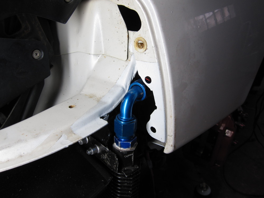

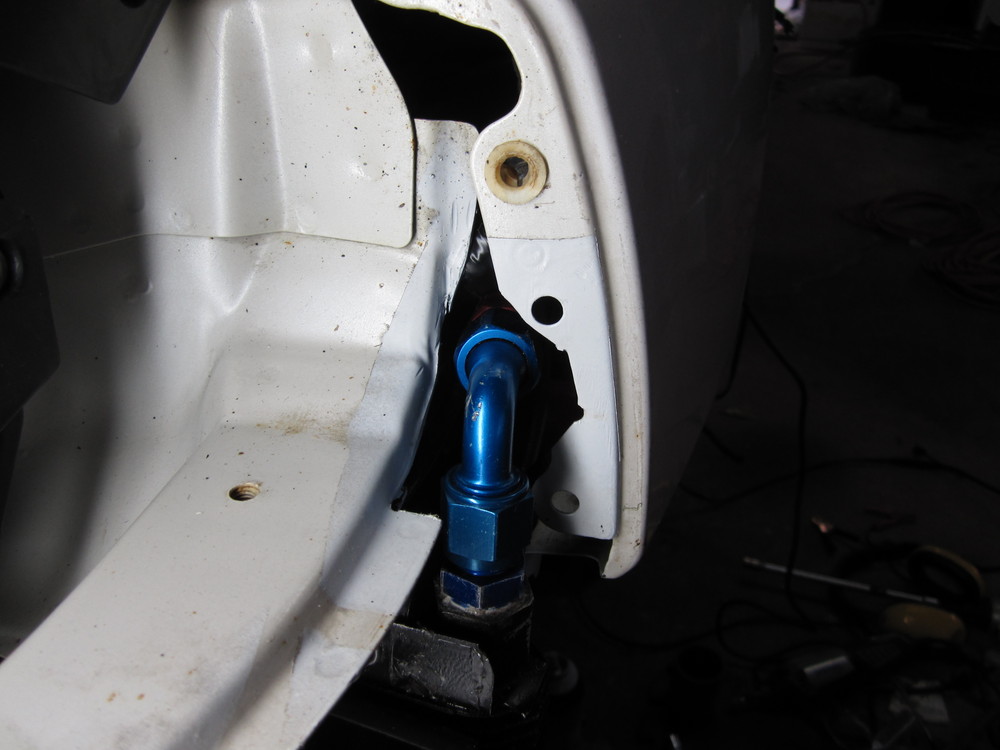

Had to trim around part of the headlight bucket and the fender. I could have used a 120 to 180 degree hose end and might not have had to trim as much but I didn't want to buy another 20 dollar fitting.

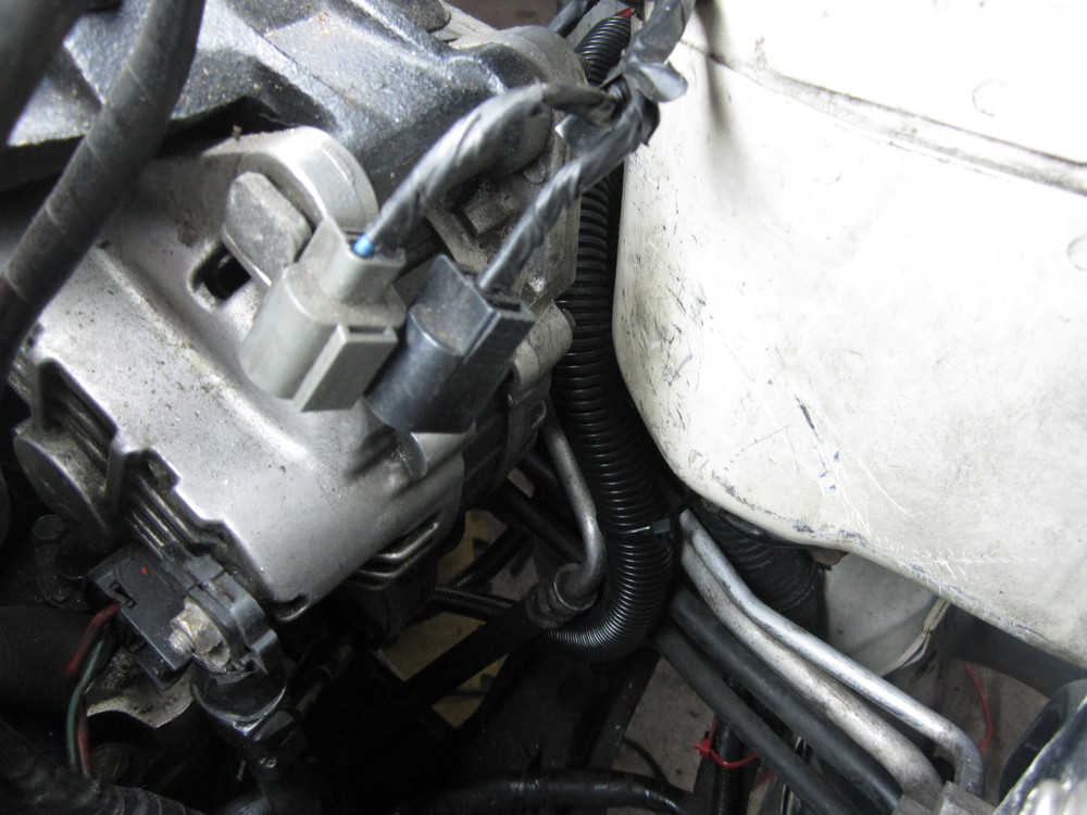

Covered the hose in wire loom to protect other parts from rubbing. I also had to tie it tight to make sure it wouldn't hit the alternator pulley.

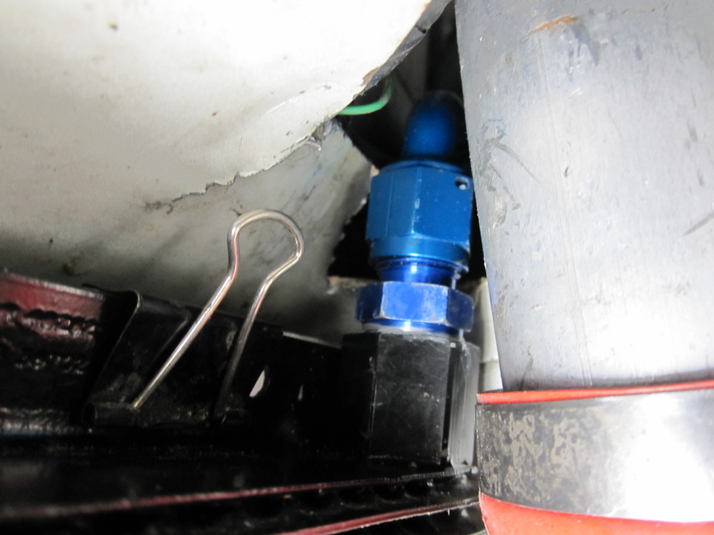

Here is the other side of the cooler. I cut two lines (tin snips) into the sheet metal and folded a flap up to make more room in the hole for the new line + intercooler piping.

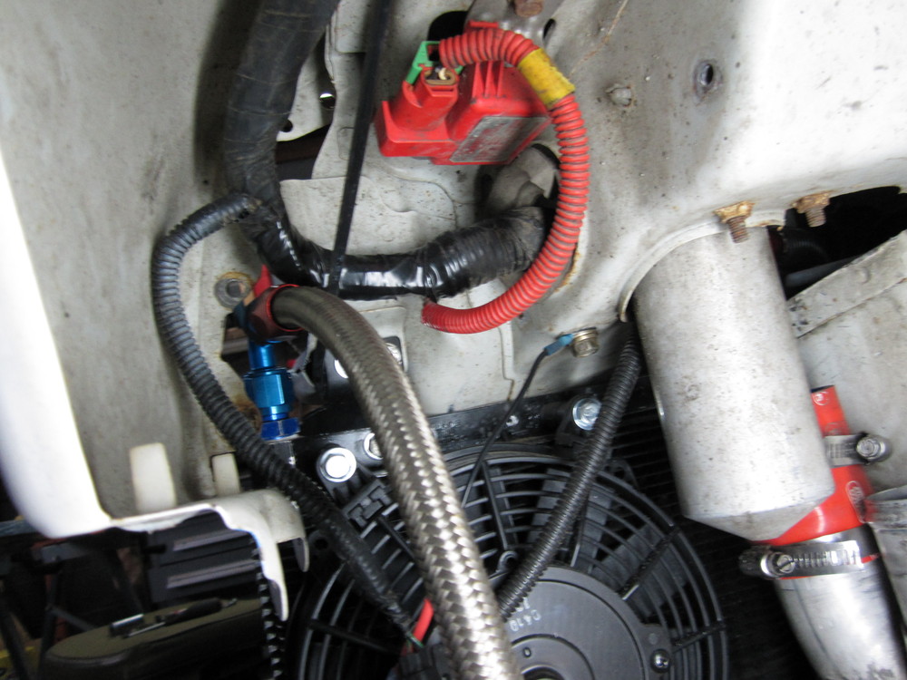

here is an early stage picture. I did some more work to file the edges and make sure it would not rub anything after.
The big thing is to make sure your npt to an adapters screw all the way into the oil cooler. It was tight and I even had to file the adapter a little to avoid having the cooler crack.
hmmm... any particular reason why you didn't mount it with the fittings on the bottom?
While the core would fit upside down the fittings would be sticking down more and I'd be worried about ground clearance and breaking off the fittings. Doing it this way lets me use the available space on the sides for the fittings. Also I'm not even sure if it would fit to the side of the ypipe. Currently the yipe is tucked right up against the body for that to fit with the rest of the piping.
Because when you shut off the car all the oil in the cooler doesn't go back into the pan. It will give a false reading on the dipstick. Oil coolers need to always be mounted with the fittings up.
