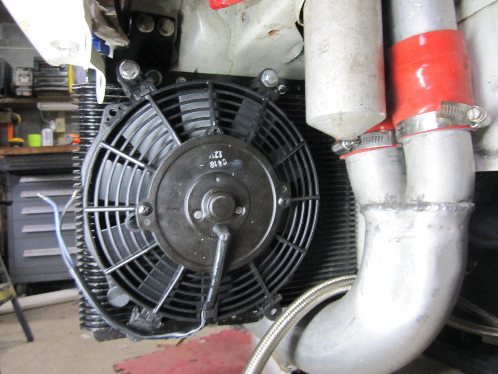

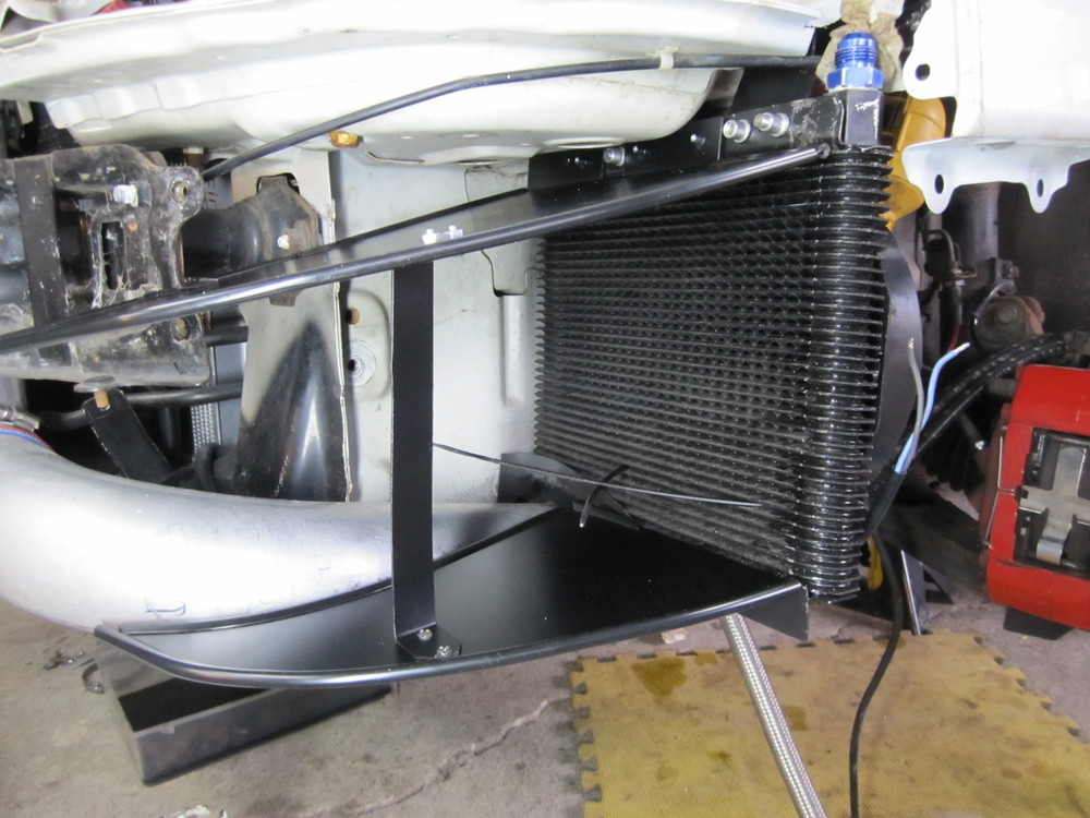

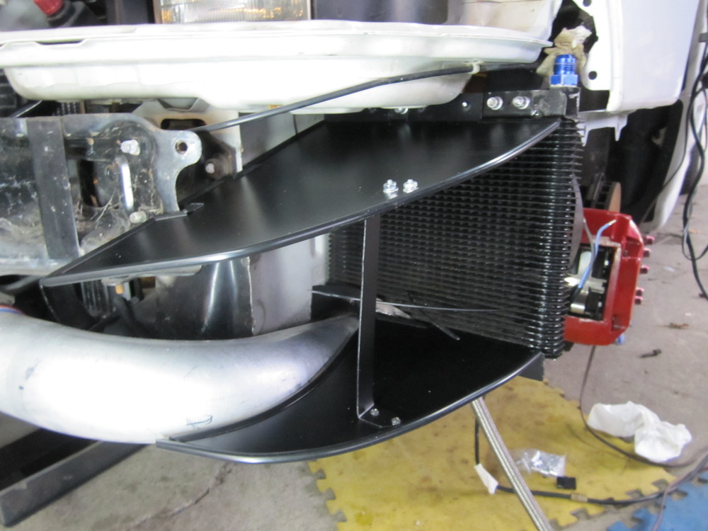

    I had the B&M 70266 8x11" oil cooler in the front when I had dsm sidemounts, went with a FMIC last fall and needed to move the cooler to the side. I didn't bother last year because I new it would barely fit and would take some work. Decided to tackle it this weekend. I also made some ducting and added Derale 8" fan.

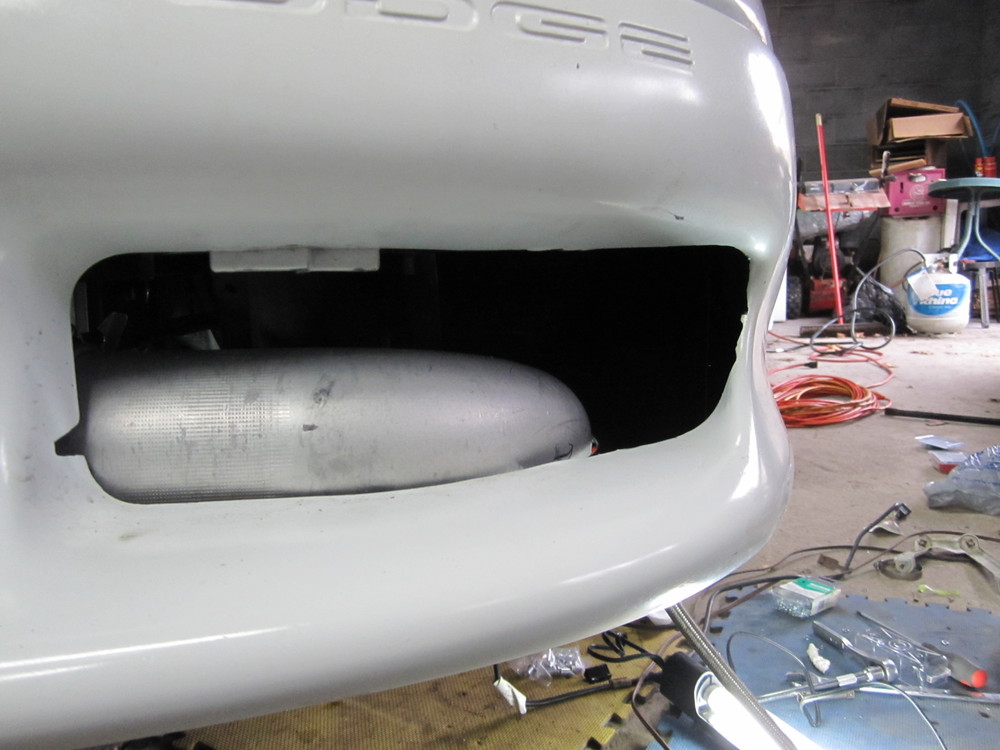

    I had to do some trimming where the an fittings connect to the cooler. It really just barely fits. It is literally touching on all 4 sides to something. Bumper still fits without any bulge
    I still have to do some wiring and figure out the crash bar....

    Damn! Love the shroud! Really nice man!

    Looks great, I like the idea of the air flow trap straight to the oil cooler. Right on!

    really slick looking!

    Thanks, I just wish it didn't take so damn long. I feel like custom work tends to take me 3x longer than I expect even after I pad for knowing it will take me 3x longer...
