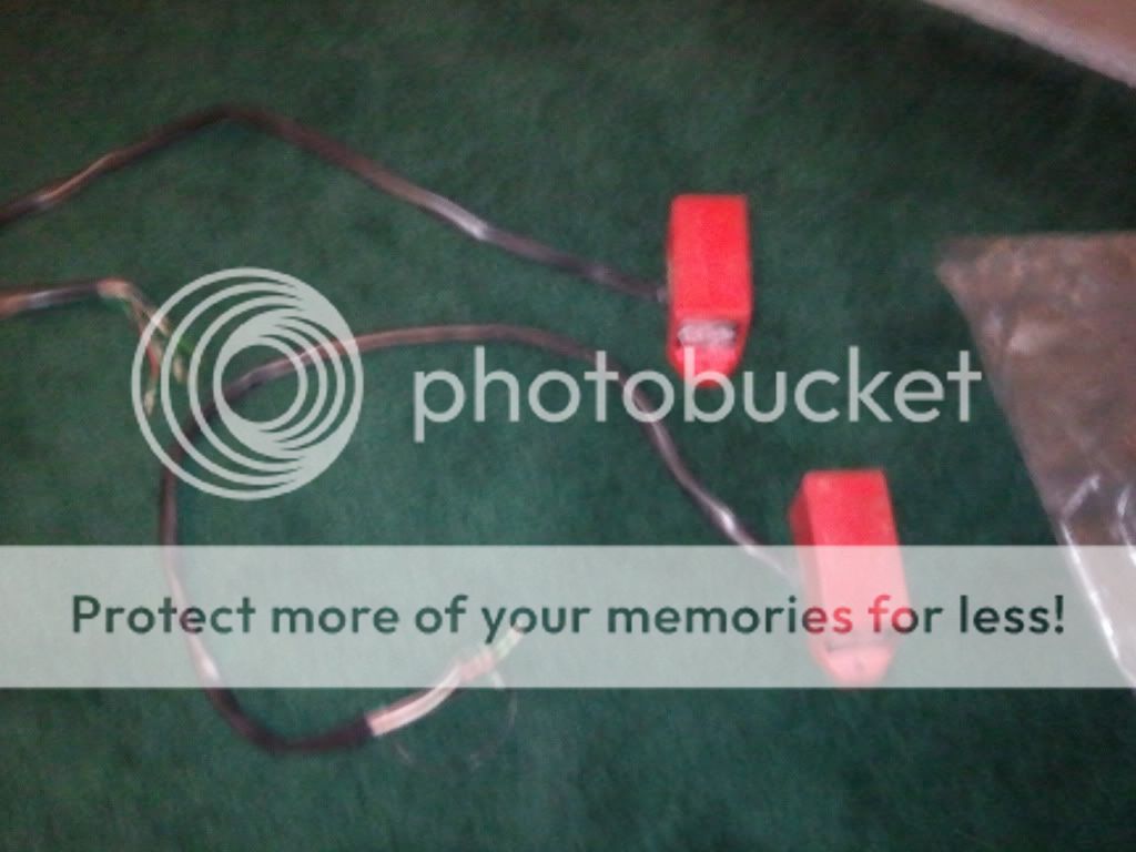

    what do I do with the two "Dual Ignition Adapters" then?
  11. #29
    I AM IMPORT POWER
    Driving Vicki Crazy
    1,105
    56
    Thanked 270 Times in 125 Posts
    Unfortunately, many are told they need them and buy them. Unfortunately again...they (tach adapters) fail rather quickly and many times are DOA.

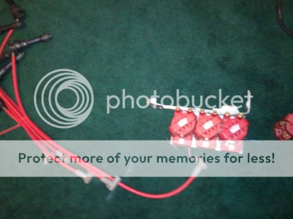

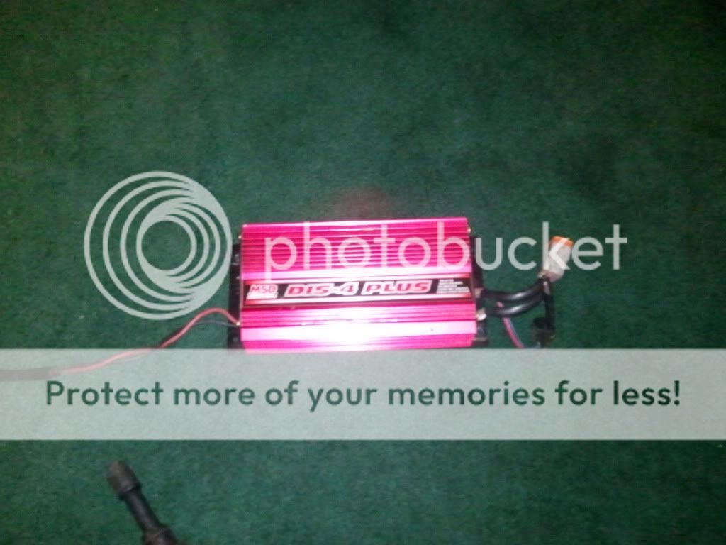

    this is what I have, and he's sending me another harness he forgot to ship with it also.
