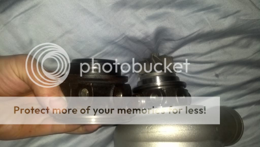

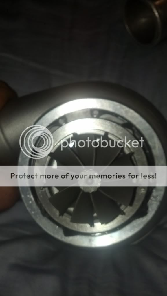

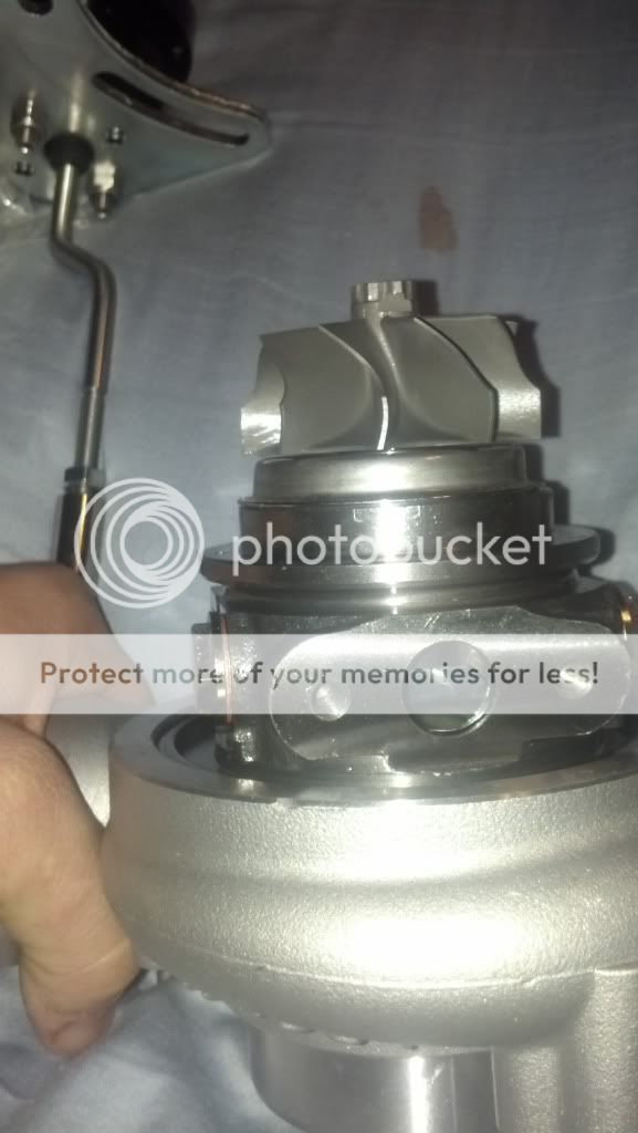

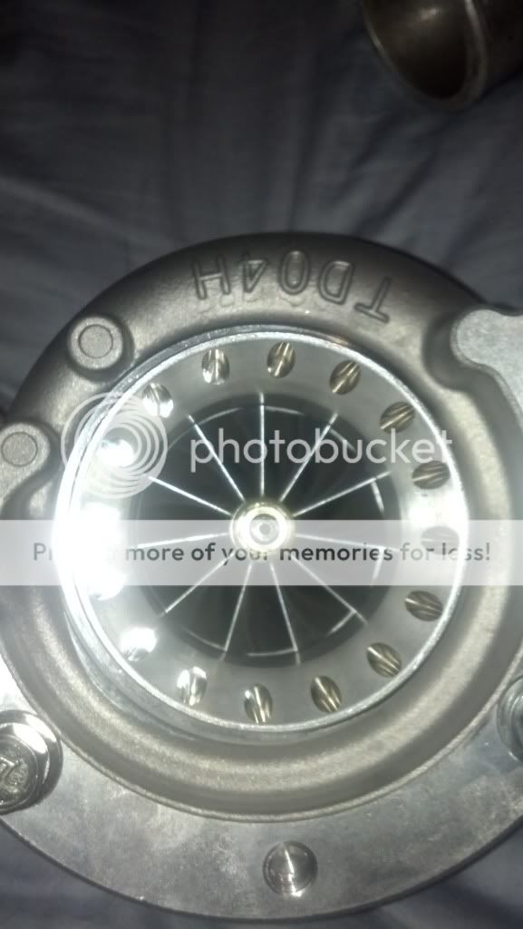

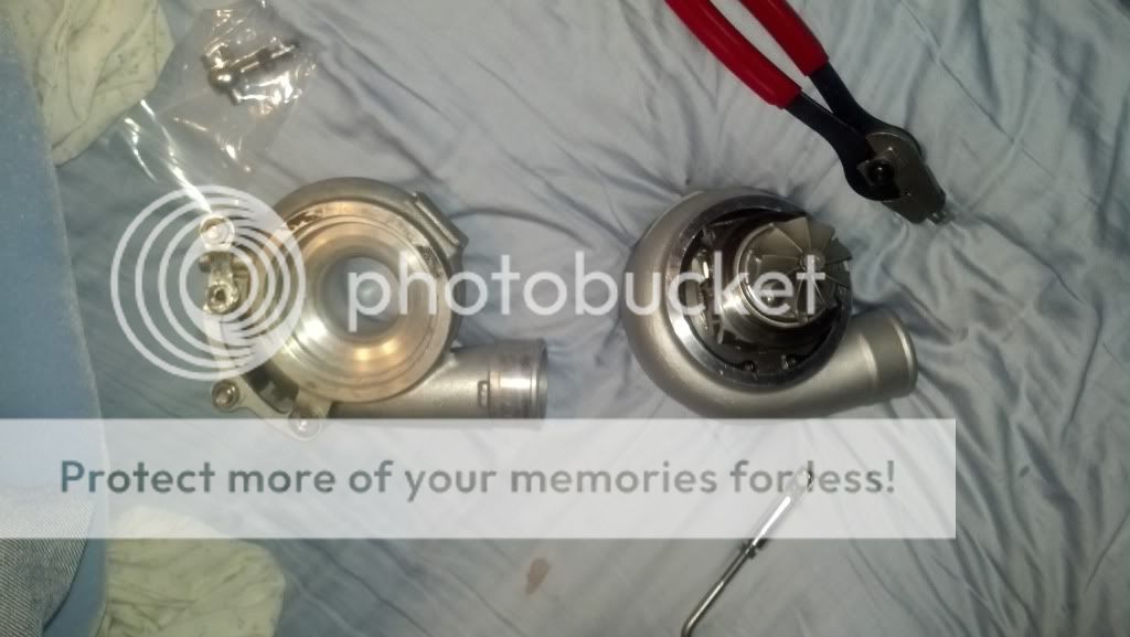

    TD04-HL billet 11 blade extended tip 19T's with 9 blade turbine wheel and antisurge compressor hosuings. FORGED Billet adjustable wastegates 7psi springs untill the engine is broke in, then the big ones go in
    31202_192621_572_zpsdb830594.jpg.html][/URL]
    here's some pics of them next to the 13T compressor housings.
    here's the turbine wheels profile
    lets see how this helps out with the surge
    the big boys...for later down the road
