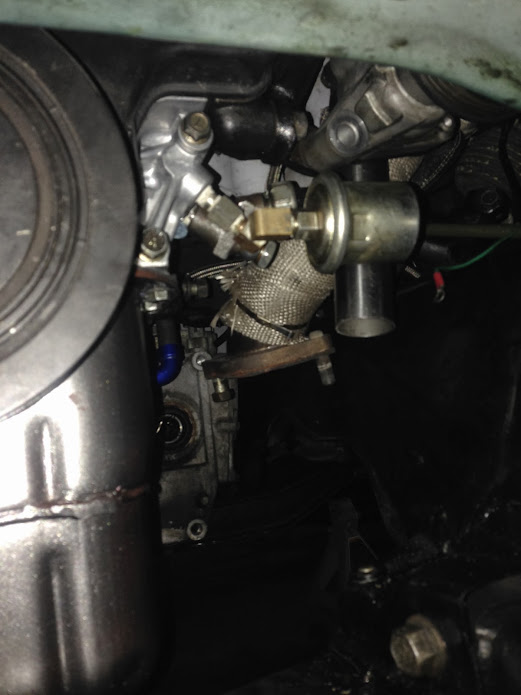

    Engine made it in....
    Rear wastegate fitment is almost like it was planned.........
    Can probably run it as is, but will likely snake an extension down under subframe and back.
    Alternator mounted, but not much else. Travel for work for a few days, so won't get back at it until this weekend. Hopefully atx intermediate shaft will be here by then also.

    Have you run your car much open exhaust? It gets pretty dirty under there
    Back when I had open dumps on JPDC adapter plates I used shitty flexible steel exhaust pipe to extend them... It actually worked just fine.

    Was thinking about a flexible pipe. Would definitely be easy from where it is now. Seems like cheating though since I have the welder

    It gets super damn dirty under there with dumps. Looks like a diesel running open downpipe lol.

    E85 is much cleaner but I will be adding an extensions anyway. More to make sure deoxygenated air goes out of my engine bay and no chance of turbo ingesting poor air.
