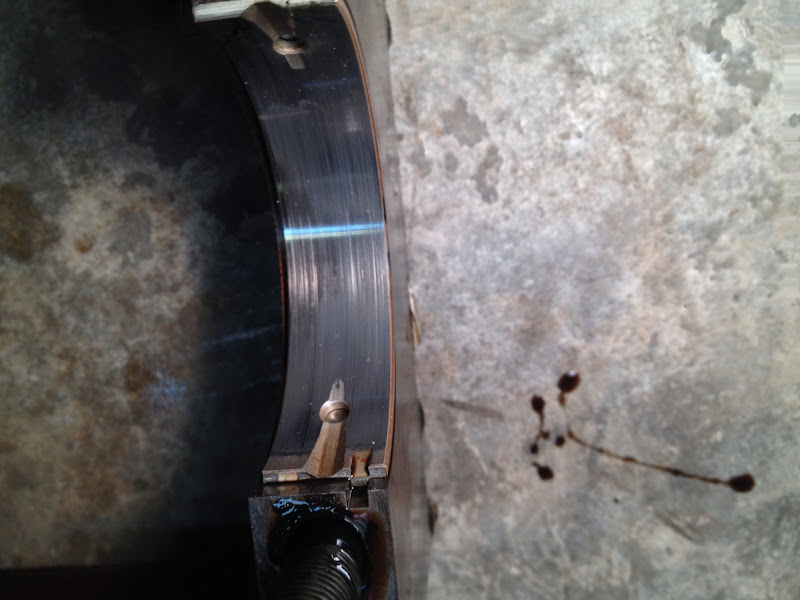

  10. #3830
    177,000 miles on em...
    The worst of the mains:
    The rest: https://picasaweb.google.com/1141724...ICO2-O74PHjYg#
