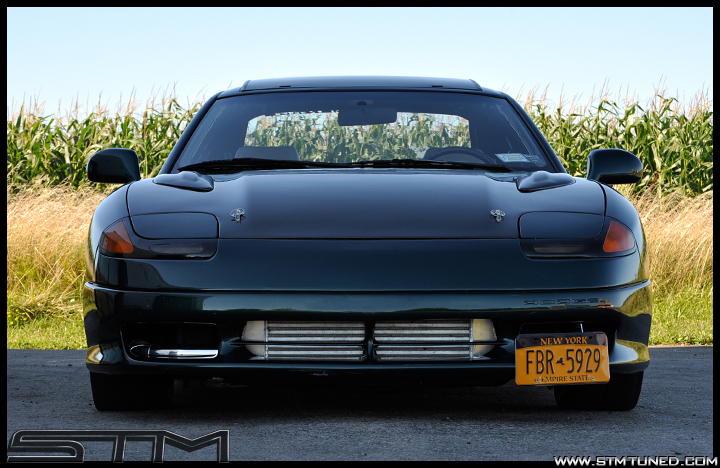

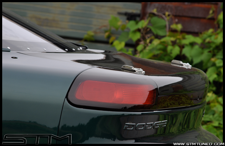

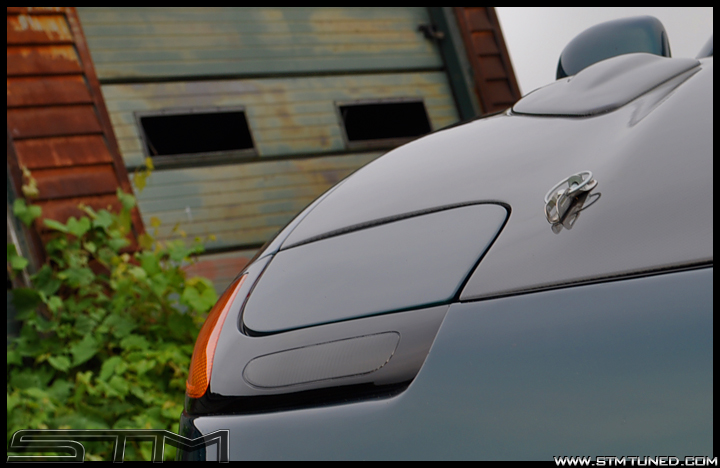

    Yes you will want hood pins. I run the sparco ones on my car, but there are plenty of options out there. I wouldnt trust any hood besides stock with just the latch. I have seen to many times where people even just going highway speeds have had hoods fluy open on them because they didnt use pins.
    Fiberglass and carbon fiber are strong but also brittle. Everytime you slam the hood you weaken it, and at some point that little metal hook will loosen up.
