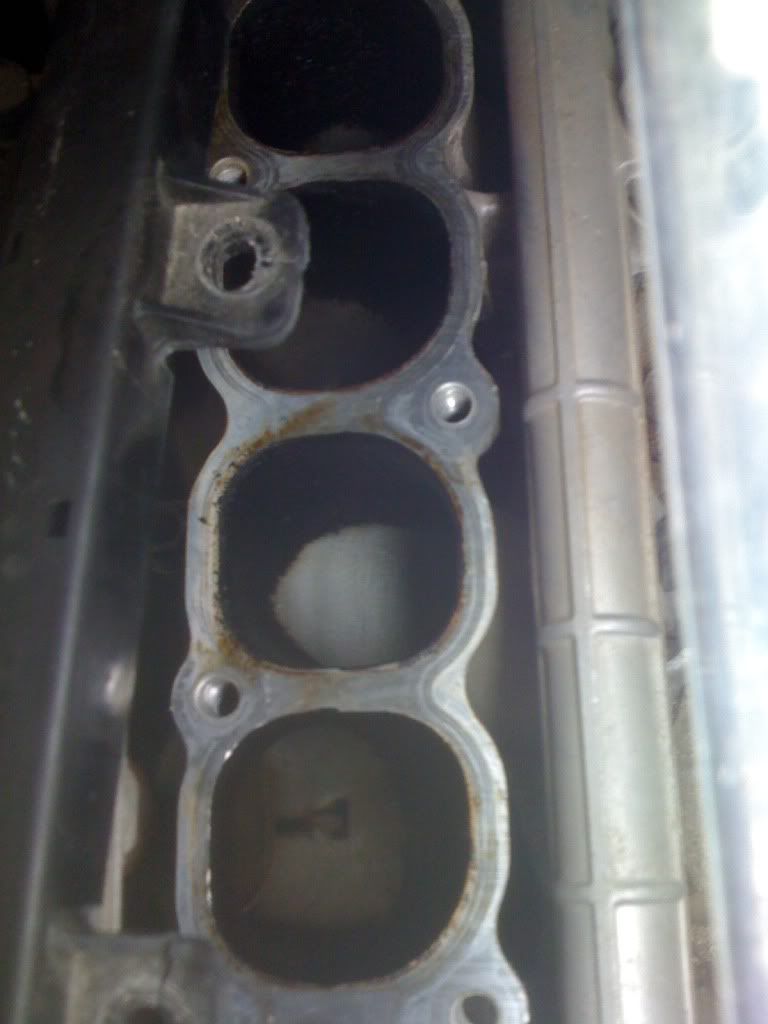

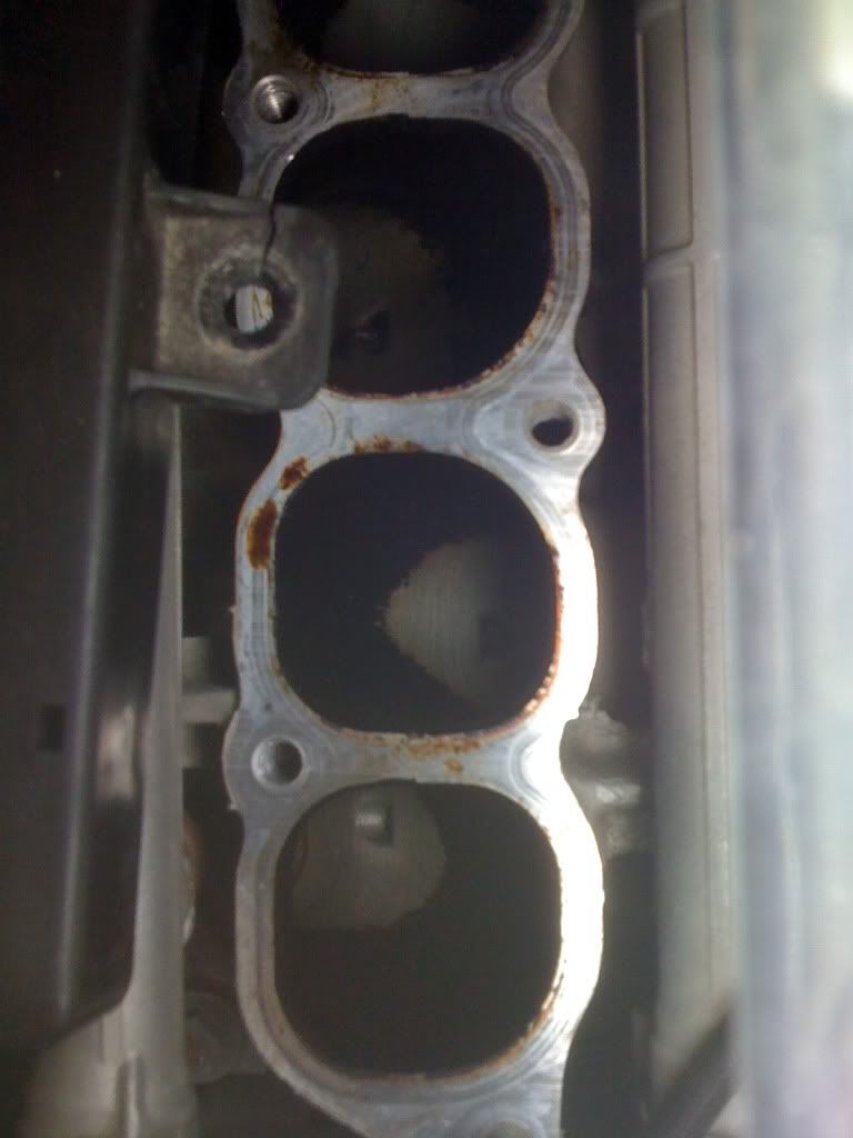

    Hey guys, I am in the process of changing my spark plugs and wires today. After I pulled the plenum I noticed that all runners in the lower plenum seem to be very dirty. Is this normal? Should I clean this out? If, so what should I use? Can I still do it with it installed on the car or should it be removed first?
    Thanks, John

    I'm curious what others say. I have never worried about it in mine. If it makes you feel better be super careful to not drop anything in there and clean it out a little with a rag but it's not doing any damage to your motor if you leave it alone.

    I used a throttle body cleaner by (CRC) and just pushed everything down with a new toothbrush to where the injectors would spray the left overs with fuel. Once its all put together and you have it started I suggest using a fuel additive that will clean the rest of it out and burn it. There was no problems when I did it. I used a more expensive fuel cleaner BG44K to a half tank of gas (91 octane) although they do recommend a full tank. I wanted a more concentrate solution. After about two tanks of gas I was due for an oil change so I added ZMAX to the fuel and oil. Car is running great now! =)

    well if there is oil on the plenum(like on the picture) then the gasket was leaking
