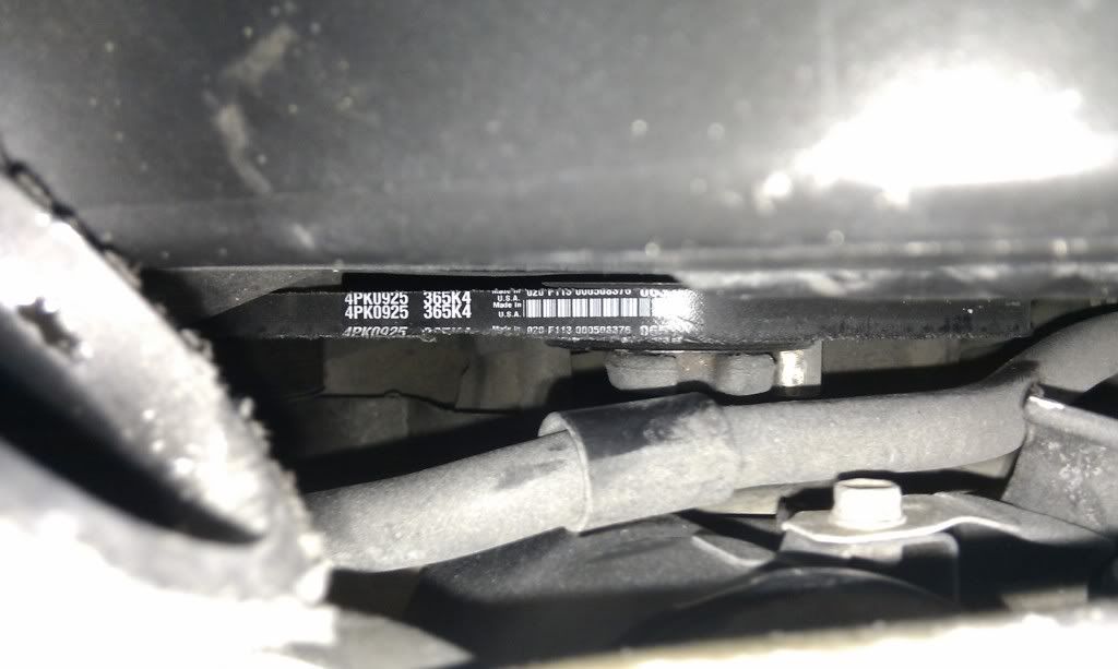

    While changing my spark plug I noticed that this belt was getting worn. What's the name of it? It's right below Air Pipe A.

    That's your power steering belt.

    What he said. You have to remove the AC/Alt belt to get this one off, so you might consider replacing both at one time. All the parts stores carry them; I would get the least expensive O'Reilly/Advance/AutoZone belts and go for it.

    Not totally true that they all carry them, I had a hard time finding them locally. I also wouldn't suggest buying the least expensive... I did that, the belt went bad at above highway speeds the exact same day I installed it, and there was nothing left. Had to drive an hour in another vehicle to go get another. I ended up replacing belts at a rate of one a week for a month and a half before I went and bought a goodyear belt. I was less than thrilled.

    Gator backs are the type to use, only reason i had to replace both of mine is because the idler pully its self fell off( guess I didnt tighten it enought after rebuilding my top end hehe)
    I definitely wouldn't cheap out on it. Too many times I have seen peoples power steering belt shred then cause the car to jump time.
    Are bent valves really worth the $7 saved?
    That really shouldn't happen unless you are missing some T-belt covers or it wraps up around the crank pulley in a really bad way. Anyway, I'd go for a known-brand quality one, no reason to cheap out on such stuff. As stealthee said, drop a few happy meals and pony up ~$7 or so for piece of mind
    Thats what can happen if it shreds. It wraps around the crank. T belt covers wont even save you then.
