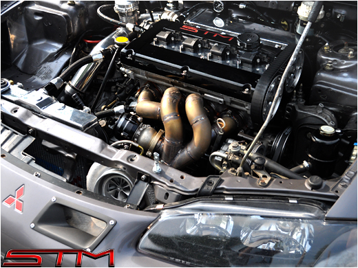

    Time for an update, i started working on it again, got in the material to do the front end, so i got it all prepped, and starting thinking of ideas for where to put everything.
    here is pretty much the final cut on each side, i will clean it up a little more before paint but its where it needs to be for now.
    heres what im thinking for turbo placement with one of these cutouts in the bumper.
    I think im almost completely decided on just going with a single turbo, that was my first idea and i still think the best one. Probably a 6262 for this year, then have it rebuilt into a 6765 next year when its time to go really fast.
    -austin

    Looking forward to seeing what you do with the front end. That single would go great right there, nothing nearby to burn up and right in the path of incoming air.

    Quote Originally Posted by Austin@STM View Post
    This looks COOL.
    Looks like a pleasure to work on; all that room after removals, shorter radiator, etc.
    -austin
    You should try out one of the new comp turbos in billet
