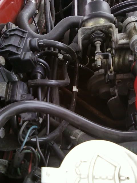

I wanted to do a vacuum reduction to get rid of a bunch of lines, get a line dedicated to my two MAP sensors, give my FPR a dedicated line, but keep EGR. Here is a diagram of how I did it attached. Still cleans everything up and runs well
I actually ended up switching where the BOV line and FPR line go on the TB, but other than that I did it like the diagram shows. Obviously I also have the other end of the T connected to my second MAP sensor unlike in the drawing. I used abut 5 feet of 3.5MM line, 5 feet of 4MM line, and a little less than 5 feet of 6MM line. Got it from HoseTechniques.
