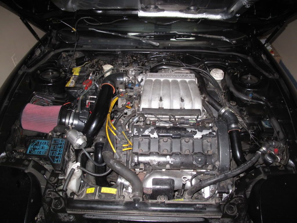

Set-up :
DR750's
Boost cooler stage 2
ETS FMIC
Denso 660cc
Denso Fuel pump
BAP
DR-ARC2
RPS Max Street 6 puck disk
RPS Max Street Flwywheel
CFDS
Custom quad tips exhaust
HKS Twin power
3SX cam gears
Stock OEM 2 bolts Shortblock (forged crank)

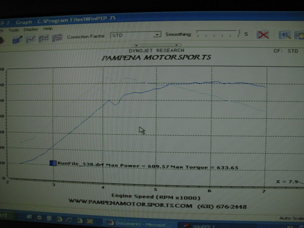

I have two nozzles to inject water/meth, a 625ml and a 375ml and I use a mix of 33% water & 67% meth on 94 Canadian pump gas. With the cold temp I can run 30psi in the street to the redline with only one count of knock. So 28-29 to be on the safe side.
Ray dynoed my car with my street trims, unfortunatly my MBC was failing on his dyno (I don't know why, cause it hold on the street), so the boost was raising to 30psi but was falling down to 25-26 at the end, it explain why I make more TQ then WHP.
Here is a few pass :
On the 609 WHP pass I had a missfire, it explain the glitch that took down the TQ.
On the 657 WTQ Ray letted go cause he thought it was too much power down low for stock rods.
What impress me most is the 650WTQ at around 4350rpm (or 500WTQ at 3400rpm). The DR750's spool so fast it's incredible.
Here is a video of a run :
http://s7.photobucket.com/albums/y27...t=MVI_2450.mp4
So 609WHP/633WTQ or 600WHP/651WTQ on pump gas + water/meth!
I think those are the biggest numbers out of a 6G72's TD04 on pump (+ water/meth) and I think it has the more TQ down low ever seen for a 6G72 (?).
