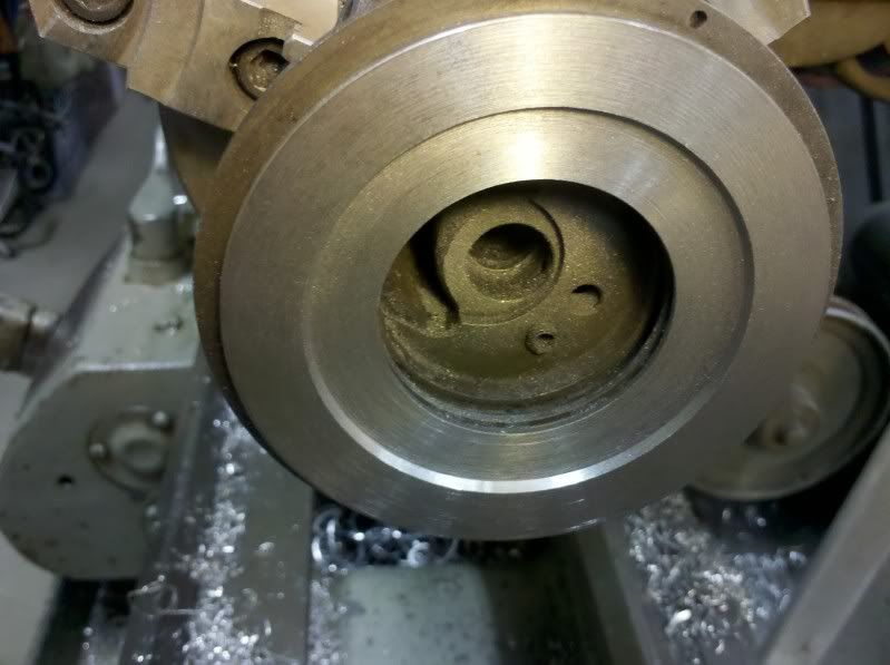

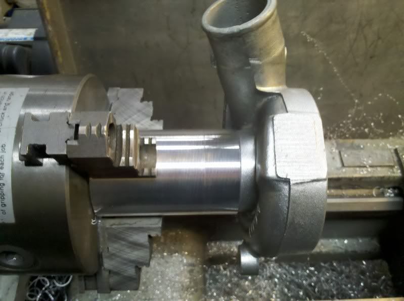

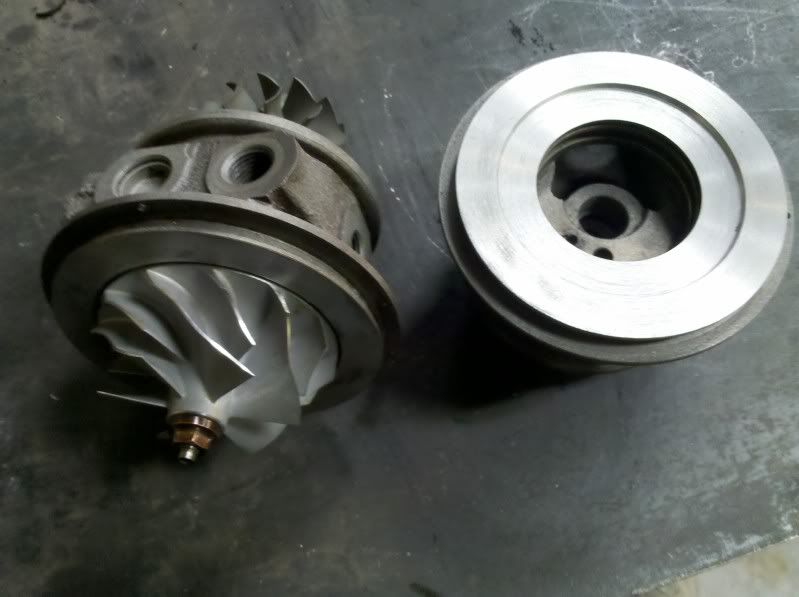

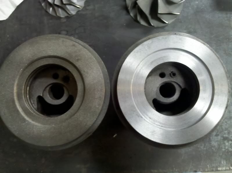

    Here's a couple pictures of Evans 19T's during the machining process:
    Heres one more pic as we are fitting the new inlet before cutting it in two and machining it the rest of the way
