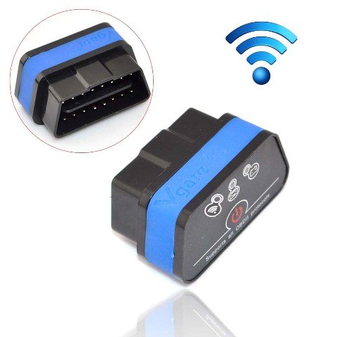

    So... I have great news!! I figured it all out and it works.
    The big issue is tracking down a Dongle that actually works. I went through about 4 different ones before finding one that worked. 1 was bluetooth which don't work with IOS due to Apple Bluetooth protocol not being supported. The nest two I ordered were Wifi dongles. The first one the guys sent a bluetooth on accident, refunded me and told me to keep it, the next one just did't work. Assuming due to our Baud rate as it works on my 2010 F150. The last one I got was more expensive than the rest at $32.00 (rest were all in the $10-15 range). iKKEGOL WiFi adapter.
    Amazon.com : iKKEGOL iCar 2 Mini OBD2 OBD II WiFi Car Diagnostic Scan Tool for IOS iPhone iPad PC with Switch Auto Sleep(Black+Blue? : Car Electronics
    Shipped fast and nice packaging. You can tell the instructions were originally not written in english...LOL
    I downloaded OBD Fusion for my Iphone. It cost $9.99 and is very robust I think for the cost. It does allow you to add in custom PIDs to log other things which I am still working on figuring out. Big thing is adding Knock to them as OBD Fusion does not have it as a standard selection. So I'll need to get with Greg E and try and figure it out.
