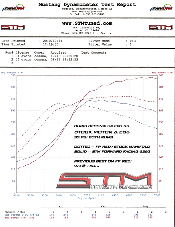

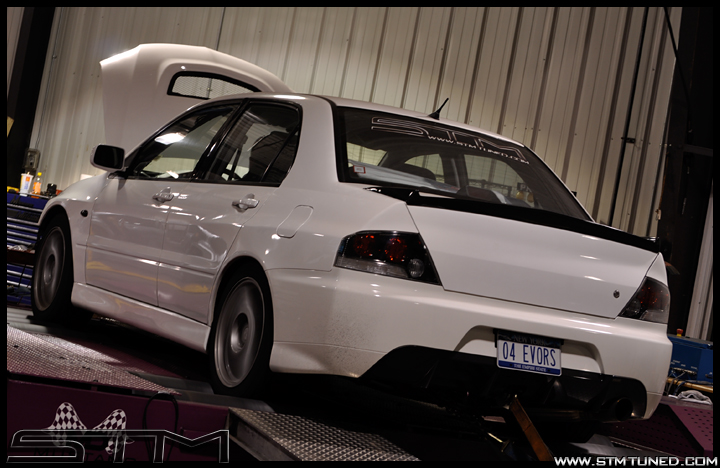

    In the Evo community the story behind Chris's 04 Evo RS is well known, first 4g63 to hit a 9 in the quarter mile with a stock bottom end on an FP Red, but there is always room for improvement.
    The head has NEVER been off this car!
    Here is a video from his FP Red set-up:
    (There are a lot of "inside" jokes in the video, but definitely one of the best! Props to Brian Gleason for the editing skills!)
    There was some competition to get to that 9 second pass... This car got there first with a 9.99 @ 140, but no more than 12 hours later, the time was beat by an Evo from Georgia hitting a 9.95@138 with an FP Black...
    So we are on a mission to get that record BACK!
    Chris, being first and foremost like family to us, is also a very dedicated customer. He puts his full trust in STM and while he is off serving the good old USA... it's time for his second family in the states to fab up something new.

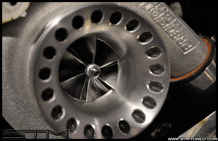

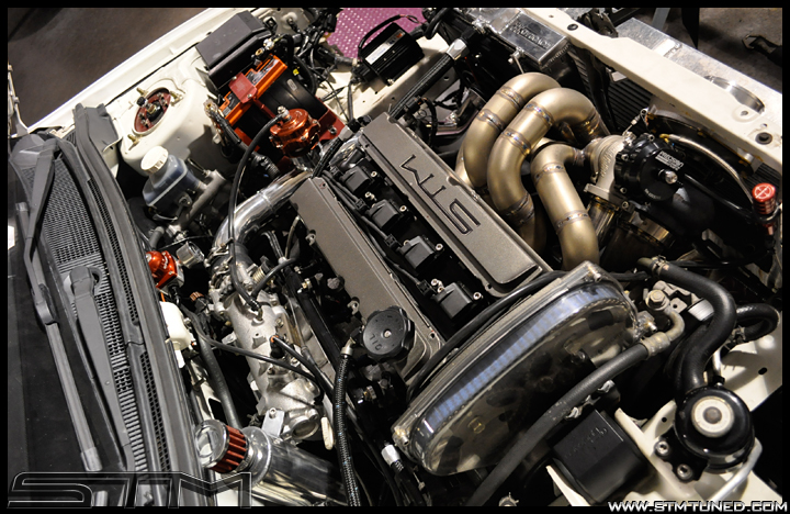

    So we decided it was time to go balls to the wall and get it done! In went the STM Forward Facing 6262 turbo kit, bringing this car up 90 peak HP and well over 100 hp @ 7500 RPM from the FP Red set-up and the 9.9 @ 140...
    And, yes, STILL STOCK BLOCK!
    Still running the same 33 psi on E85... and wanting more!

    So it ran 9.9 with 460hp? What does that thing weigh???

    Yes. 9.9 with 460 whp on our dyno. Our dyno reads very low. The car weighs about 2850 with me in it.

    wow. 2850! I really need to get an evo! A 3S would only be mid to low 11s with some weight reduction
    Do you mind sharing the weight reduction mods?

    See my signature, my TT weighs 2740
    About Chris's car, it is an RS model which means its a little lighter to start with. It comes from the factory with no a/c, radio or speakers, no wing on the back, no sound deadening in the car at all, no abs i thnk thats about it.
