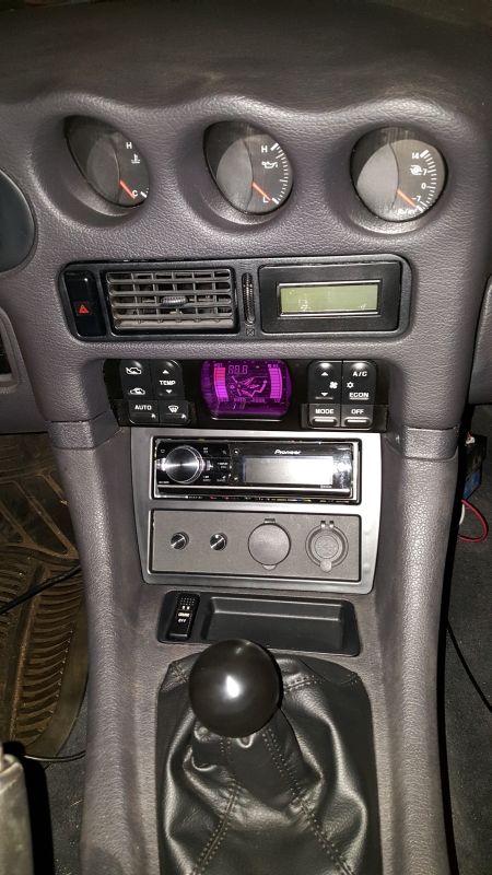

    The car took a back seat to other projects, holidays and flippin' cold weather but I have made some more progress recently on the not-so-cold days.

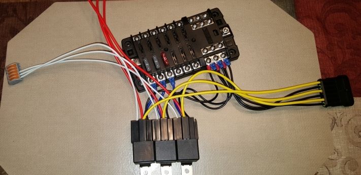

    I wired up a Blue Sea Systems fuse block with ground bus for supplying power to various doodads in the center console. I ran a couple wire harnesses with 3 power/3 ground each from the rear hatch area (where the fuse block is located) to the center console.
    I got the center console buttoned up too. After a lot of searching I found a radio delete plate to mount my knobs and USB ports into under the radio. The delete plate is Nissan part # 6847060M00. I had to drill new mounting holes so it would mount at the correct depth to the OEM DIN mounts but that was easy since it's plastic. The left knob is for the subwoofer amp bass boost, right knob is the rotary encoder for the LCDBC, left USB port receptacle is hooked to the 2 USB ports on the back of the radio, and the right receptacle has 2 powered USB ports.

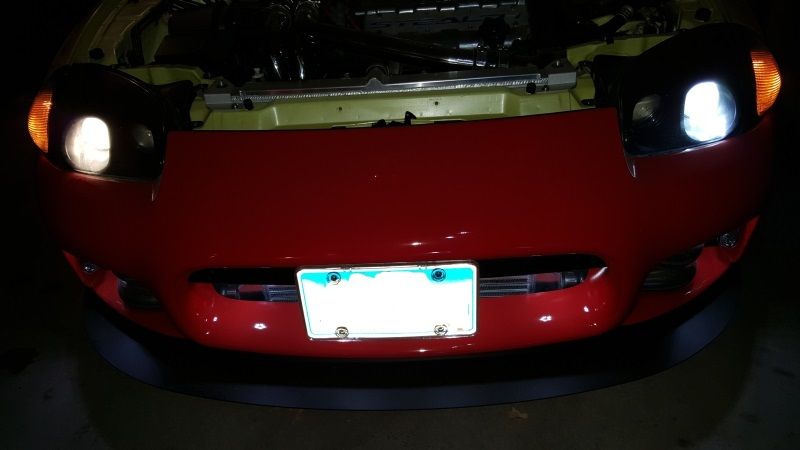

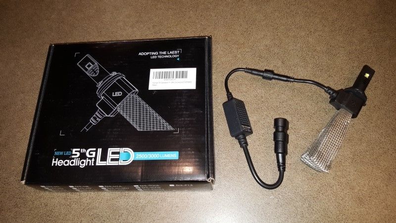

    Up front I got my FMIC lights and LED fog lights separated so that the LED fog lights work with the factory fog light switch and the FMIC lights are wired up to a remote control unit. I also bought a $47 low beam LED headlight kit to try out. I replaced the driver's side bulb with the LED bulb. The passenger side headlight has a halogen bulb left in it for comparison. I've been fighting a high idle issue so when the car is road worthy again I will test out the LED bulbs to see if the light output is good or not. Just looking at how they shine on the front of the garage wall 7 feet in front of them the LED bulb has a much crisper cutoff and the light is truly white to match the rest of the LED lighting. They have a flexible heatsink which gives enough clearance that they can be installed with the headlight still mounted in the car.
