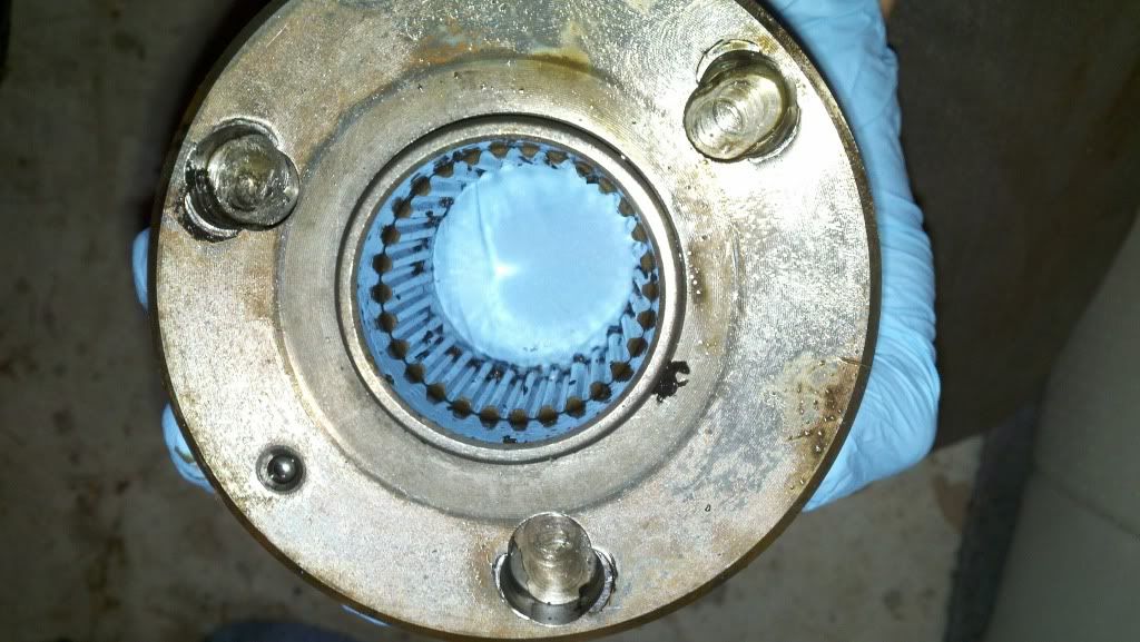

    Just make sure it doesn't look like this!!
    1991 Stealth RT/TT
    Quote Originally Posted by Boomer3000 View Post
    wow! no far as I could see the internals looked good. it doesn't have any backlash either

    that wasn't the worst part out of that tranny, lol
    Quote Originally Posted by anyonebutme View Post
    driving like forza huh?
    STL, MO
    1,144
    190
    Thanked 36 Times in 29 Posts
    pretty much. lol
