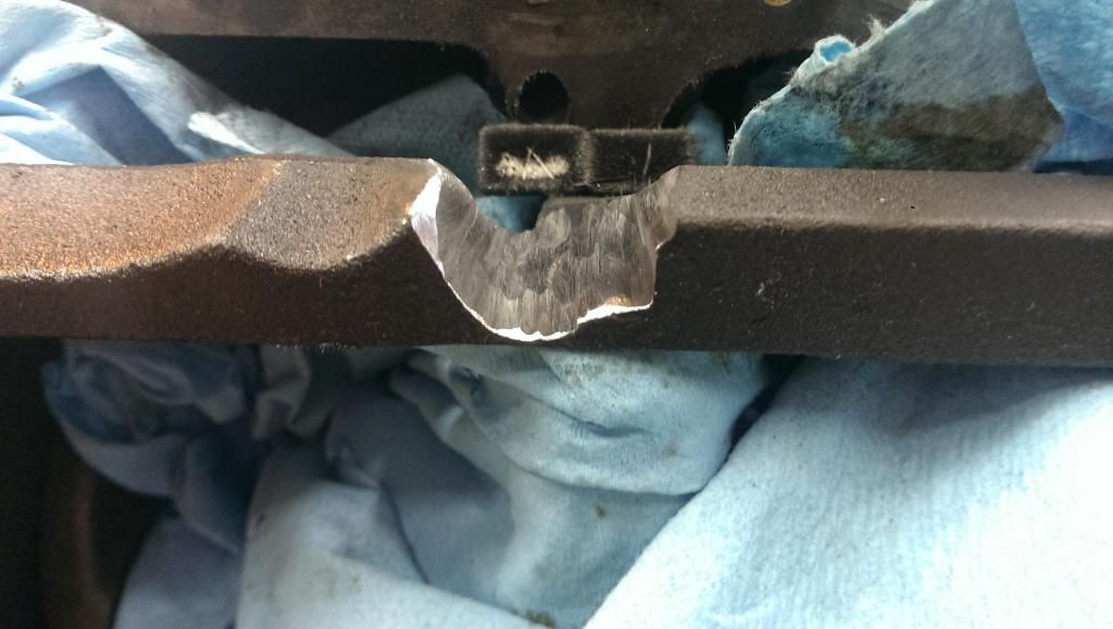

    Oil Pan Clearance
    There are two ways to go here, grind the girdle to clear a 2nd gen TT pan and drill the block for the dipstick tube, or mod the 74 pan to clear the t-case and turbo oil drains. My research on the subject returned the girdle grind to be the easier method. After doing it now though I am questioning it. I'll let the pictures do the talking.
    The 74 pan is a two piece aluminum/steel thing
    Unmolested girdle
    4-boltyness :-)
    While I was in there I replaced the oil pressure bypass spring with a slightly taller one from a VR4 oil pump
    My attempt to keep metal fragments out of the engine.
    Here I marked where the dipstick relief had to be made
    Started by cutting notches
    Then ground them out
    Still a long way to go
    Losing this 90 degree harbor freight tool slowed progress, had to go buy another one. ( I found the old one the next day, go figure)
    I started with a 1/8ish drill bit for a pilot hole, then went to a 7/16 to get all the way through. It's a stepped hole, the tube needs a 25/64 drill bit.
    I used rare earth magnets to collect metal shavings.
    Dipstick done
  8. #28
    At least my jackstands are reliable Not Verified
    Rochester Hills, Mi
    554
    47
    Thanked 56 Times in 45 Posts
    Oil Pan Clearance (Cont.)
    More grinding..
    ...a lot more
    So the girdle is actually just too fat in some places to fit the pan. Right next to the dipstick tube where that hump used to be is where the turbo drain flows into. Had to grind clearance for that to flow as well.
    Now to the other side.
    I used a cut off wheel to remove the bulk of the metal on this side to clear the t-case. Then cleaned it up with a grinder.
    The snout of the pan is a bit narrower on the steel 72 pan so a lot of meat had to be removed
    I did my best to clean the metal fragments out of the engine, but I knew no matter how hard I tried there were going to be some in places I couldn't get to. So I lined the bottom of the pan with rare earth magnets. These came from ABS pumps from late model Chryslers.
    The aluminum 74 pan flange is thicker than the steel 72 pan, you must use the 72 pan bolts. The 74 bolts are long and will bottom out.

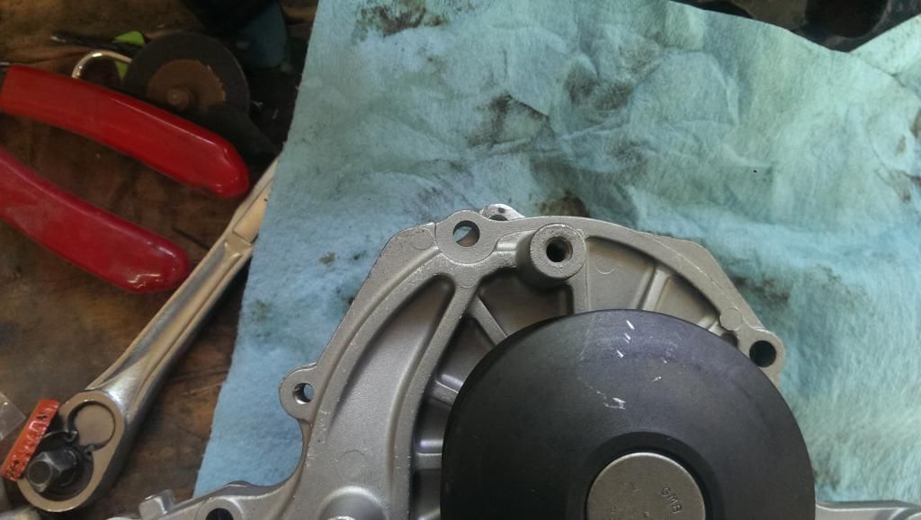

    Water pump
    I ordered the timing belt and water pump together for the DOHC Montero figuring it would all be the same. Sadly I was wrong. The belt, pulleys, and tensionor were all fine, but the water pump didn't match up with the rear housing. It was only one bolt hole off. Actually, it was also missing the boss for the bracket to attach it to the lower intake plenum as well, but as I normally leave that off it wasn't a concern.
    The original water pump was super clean and the bearing felt perfect so I used new gaskets and put it back together. I wish I had more time, but this thing is going to NG in just over a week!
