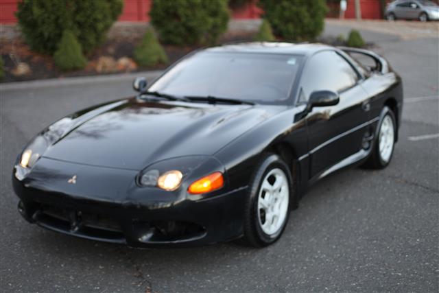

    It will take a lot of work depending on the condition of your car's paint, but its doable. Here is an example of a 99 VR4 that I detailed a while back.
    This VR4 had extremely dry paint. Dry paint will suck the moisture from whatever polish or compound that you use. The term dry doesn't mean in the literal sense. Rather, the oils that are part of the paint are simple gone due to neglect and washed with the wrong soap.
    Now, when I detailed this car in the showroom, I had to go over the entire car twice with a cutting compound and then once over with a polish just to restore some luster and shine to the paint. besides restoring the paint, I also tried to restore the black trim on the car as much as I can.
    Here are the pics.

    Correction stage: 50/50 first pass -
    Uncorrected side close up -
    Corrected side close up -
    After 5 hours -
    from this :
    to THIS :
    pics don't do the car justice. but hell that paint was horrible to work with. I went through a full bottle of cutting compound and half of the polish just to get it to where it is. There are still lots of random deep scratches that I just could not remove, but they've been reduced to hairline scratches that you can barely see.
    Without looking/seeing the condition of your car, there is no real way to tell how bad it is or how much you need to do to it. But at the very least you probably would need a dual action polisher to start. Unless you are experienced, a rotary polisher is a BAD IDEA.
