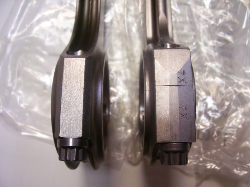

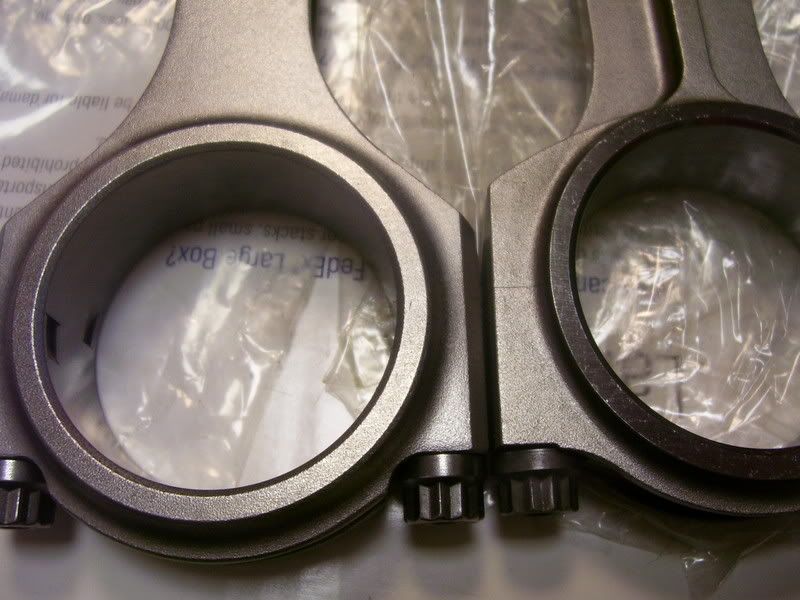

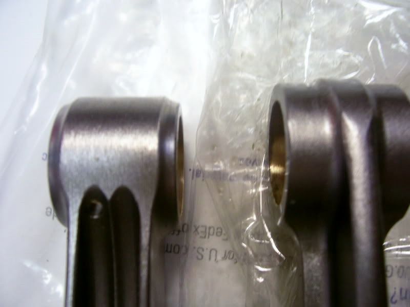

    Hey Ray, nice post back there. I did a comparison awhile back with my Pauter Rods vs. some B.C. Rods. Check this out...
    Quote Originally Posted by JeremyF / Colorado3s
    IPP Stroker Crank...
    Comparison of BC H-Beam Rods on Sandstone vs Pauter Rods on Red Jet and "Because Racecar".
    The Pauters have 7mm more thread bite on the rod bolt, 3mm wider wrists, and 2mm more material at the wrist journal.
    I know exactly what you mean about quality over weight. My 700hp engine is going on 100,000 miles. I will hit that milestone this summer. It's indestructible.
