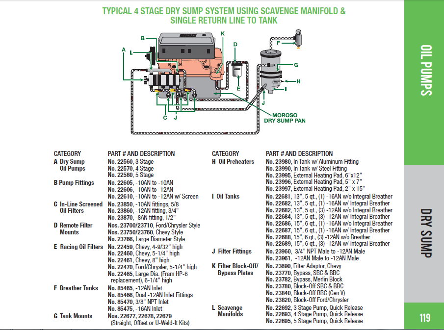

    Here's his routing diagram less one stage. He was pretty open about everything and very helpful. I like that he made mention about where to dial in the oil pressure off the bypass based on rpms. Gave me some clarity and confirmed my hunch about the benefits of using a remote manual bypass valve on a wet sump coming off the stock gerotor pump when you rev high. I'm thinking to myself out loud now... There's a possibility the belief in the stock oil pump being weak is a misnomer. There is a high probability metal to metal wiping contact is taking place in the oil pump due to cavitation from lifting and squeezing aeriated oil which leads to accelerated wear and overexertion failure.
    I pulled this design from the Moroso technical installation manual for dry sump. Unfortunately the pic's Nelson linked me to are his biz or I'd share. They pretty much follow the engineering diagram tho.
