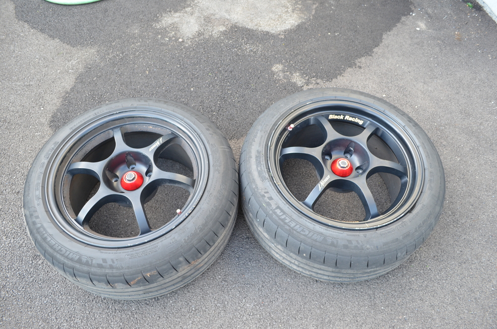

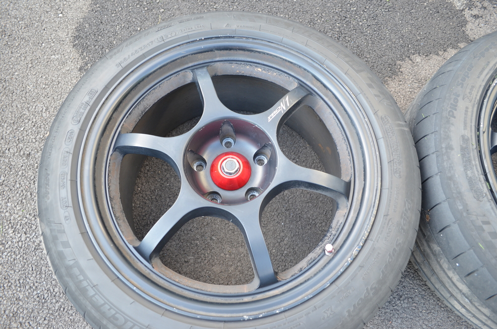

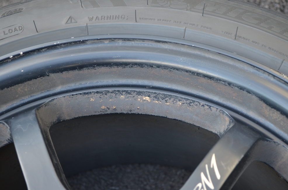

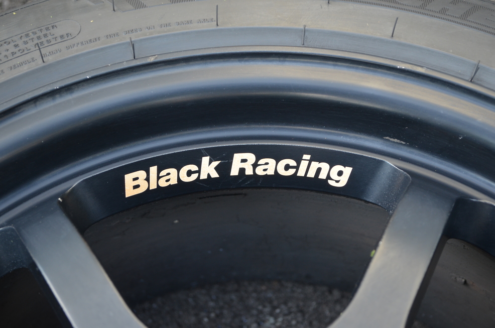

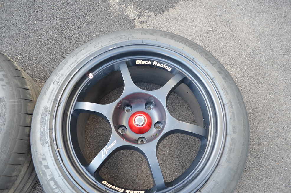

    So as Paul said, I rode my car hard and put it up wet last fall. Turns out all that brake/rotor dust rusted and caked onto the rim. It would not come off with a wheel cleaner. So I decided to try out WD-40's new rust dissolver. It's supposedly safe for paint so I decided to soak my rims in it. I took a couple sheets of drop cloth plastic and put it over the rim and bungied it around the tire. I then flipped it over so the rim and plastic was face down sealing it. I then poured two gallons of the stuff until it covered the face of the rim. I let it sit for about 24hours. I was amazed on how well it worked!
