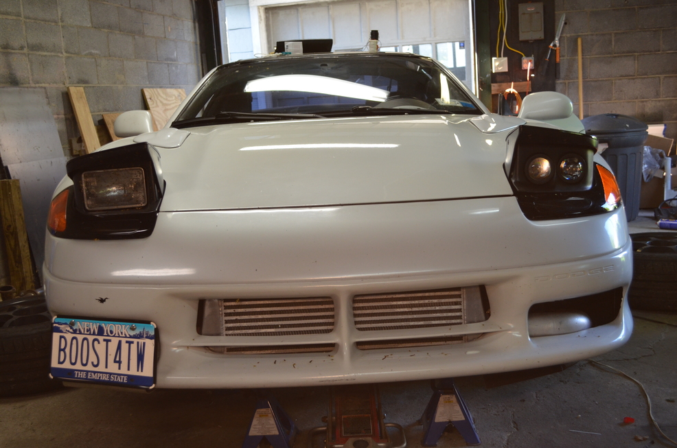

    Here is the final result (more pics/detail below)

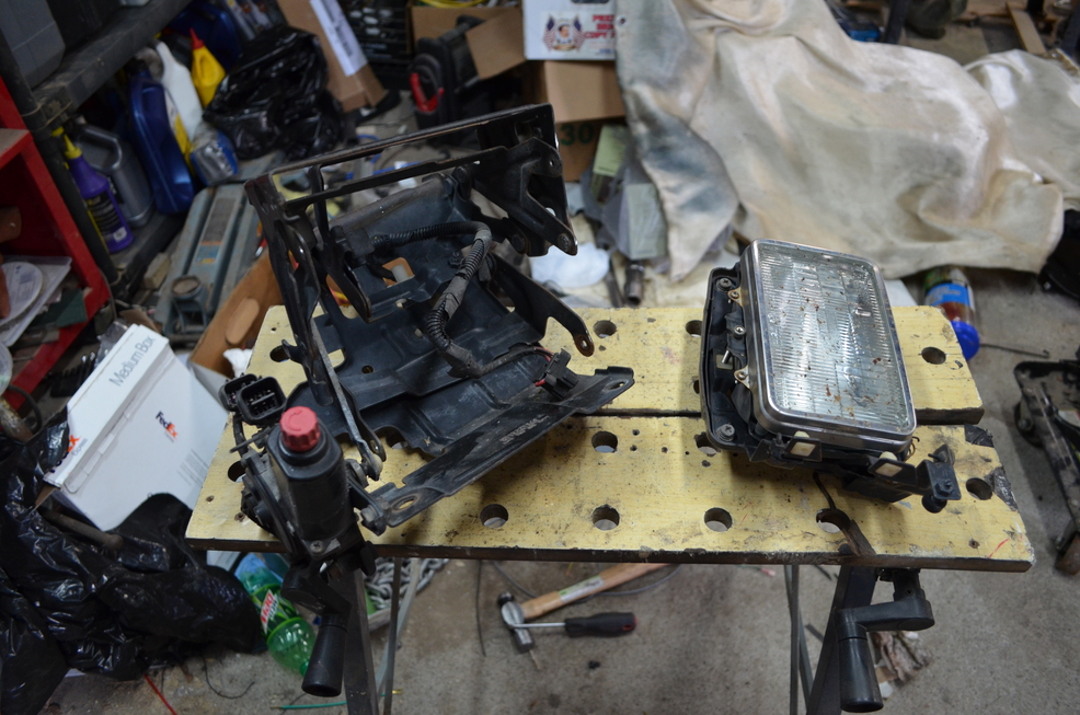

    old housing removed

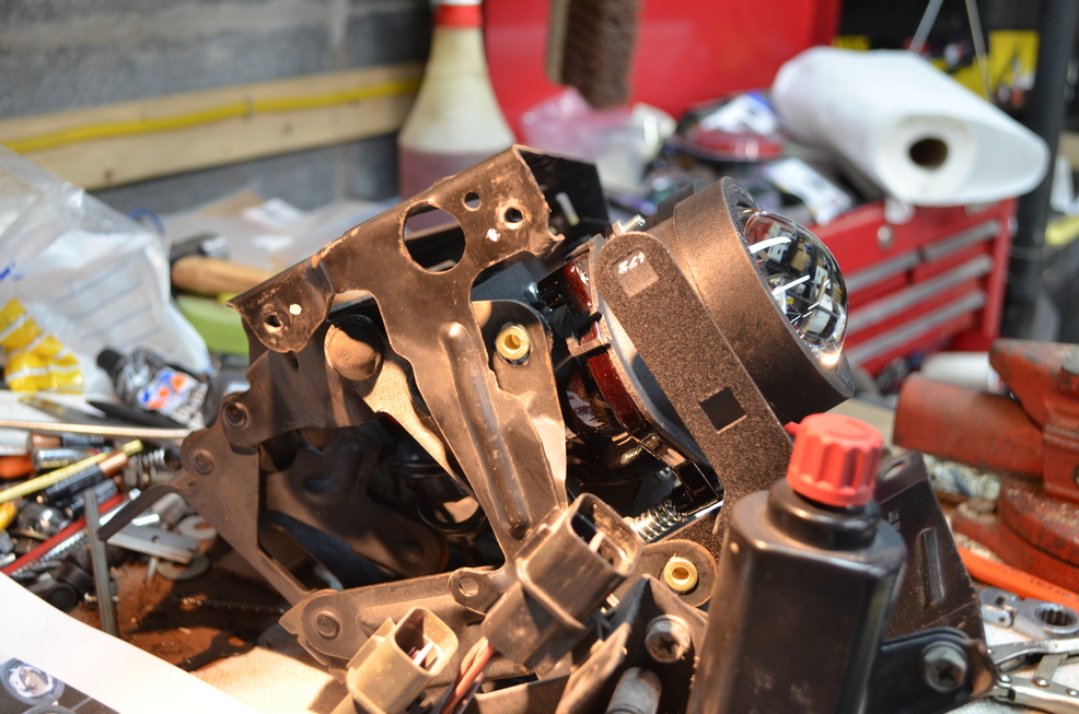

    new housing installed, you can see the goldish colored rivets

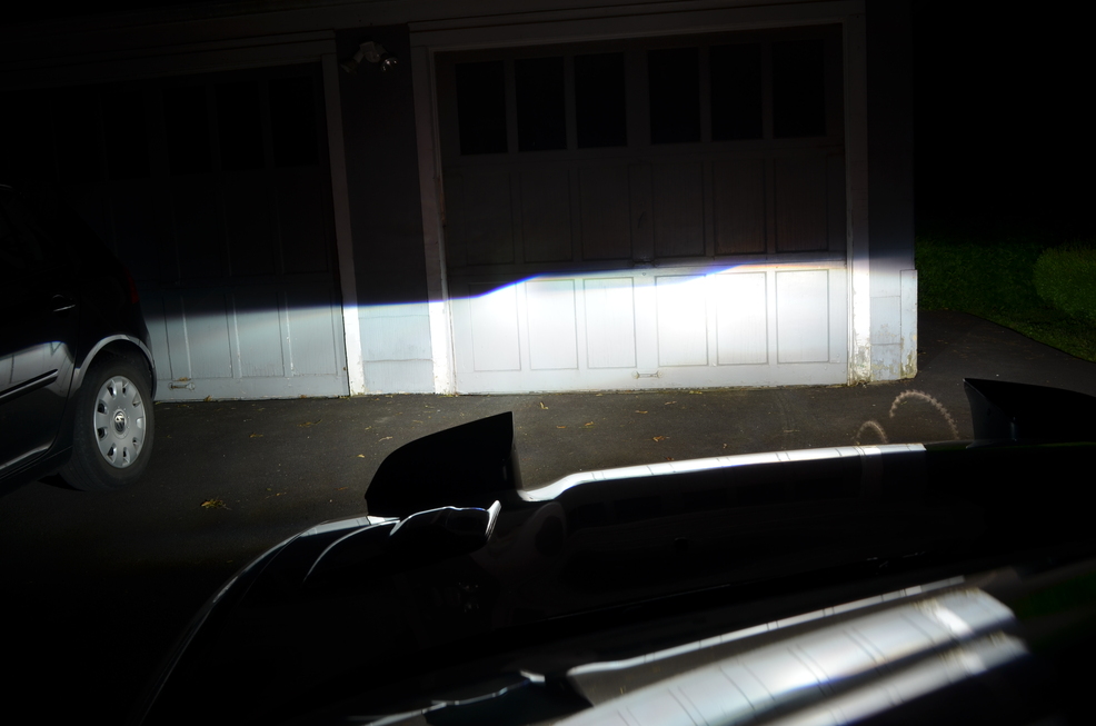

    light output. Note, my driveway isn't level.
