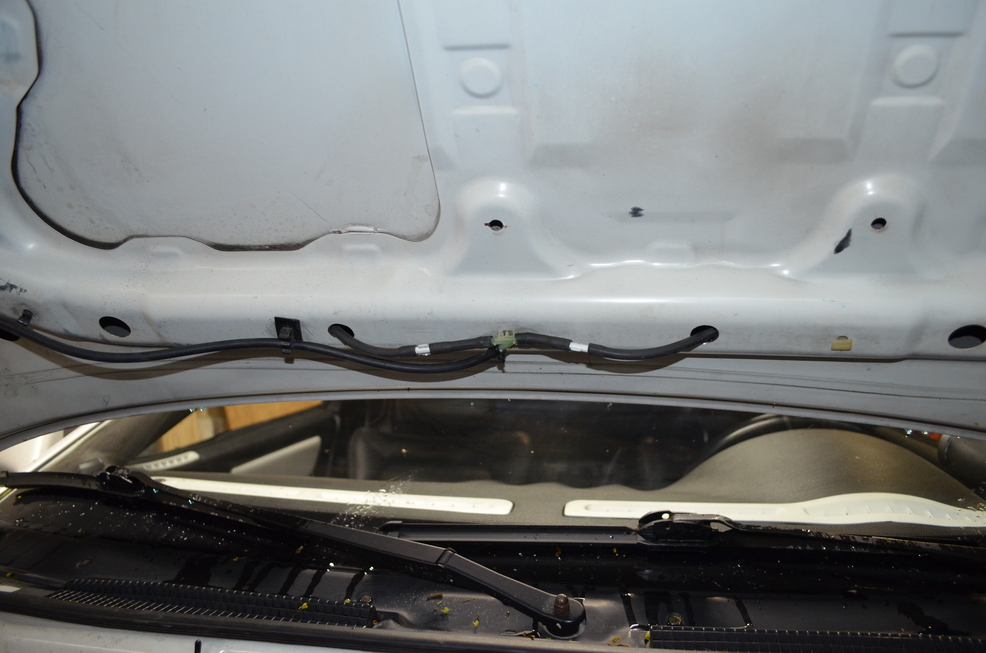

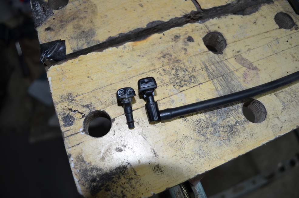

    Since I'm using my front washer tank for meth injection I plumbed the rear to juice the windshield. The stock dual jet nozzles weren't cutting it now so I switched to galant/eclipse fan spray nozzles. They are a bit different because they take a 90 degree turn. You can run a bunch of extra length hose or just drill two holes and run the hose in the hood. They clip into the stock holes. Turns out, I guess the pump just isn't up to the task either way.

    Yes! great mod! Costs about $20 here and you'll need a small file to enlarge a hole a bit (at least on a magna/diamante you will) and yeah, love mine!
    You do not need to file anything on a 3s.

    Well apparently my pump isn't strong enough. I only shoots the stream 2-3" above the resting wiper location and it's not due to the angle. I guess I can try to order a new pump.

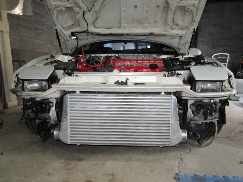

    Lol you are more worried about how the car looks than being able to see? 99 tank won't fit with the FMIC/ducting.
    Yes it does.... Depends how high your Core goes. I'm running a 99 tank for my Meth with a CX racing FMIC.

    Hmm my core goes pretty much all the way up. It definitely won't fit with ducting installed as is.
