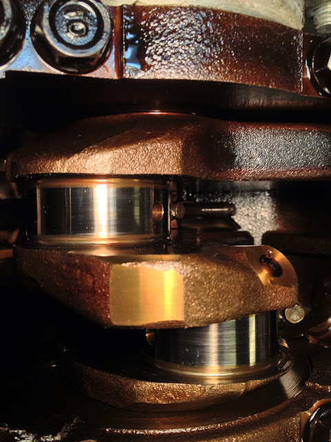

    The crank was actually in great shape. It only needed a slight polish, and like new again. I have no pics after the polish. I decided to have the machine shop assemble the rotating assembly while it was there. They ended up turning me on to the coating company I linked in the parts list 1st post. They also talked me into the ring set in the 1st post as well. I did not realize at the time the price of said rings, but have found great reviews on the. The shop does leak down tests, and these are the best performing by far. So they say, we will see.

    Little better pic of the rod bearings. This is why I decided to freshen her up before adding the powa.
