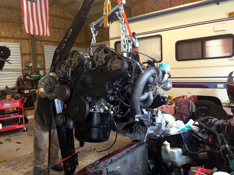

Well it is in! Thanks Larry for the help with the brackets. I should of done a little better at documenting parts once the engine was out. I was in strip, chuck, and in the truck to the machine shop mode.
Pics!

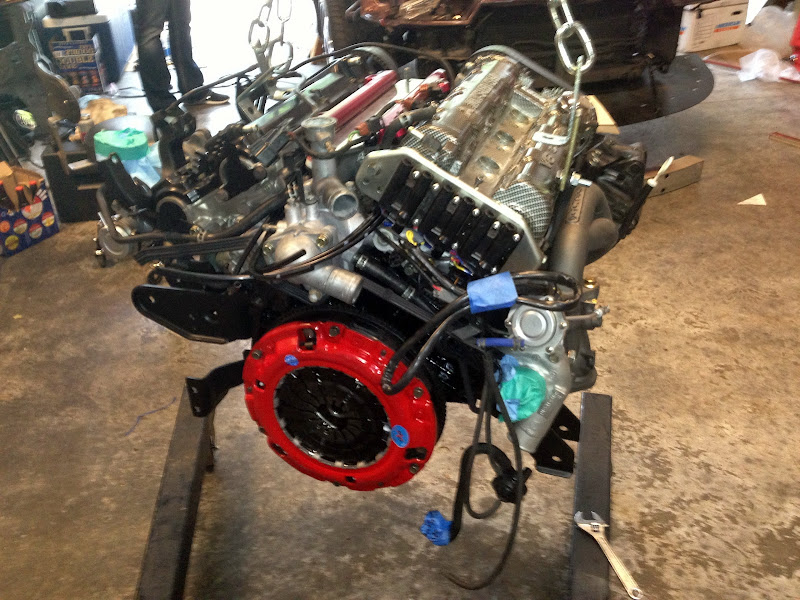

Clutch on.
Nathan attacking the clutch line to replace.
Trans on, after pulling off twice! Brandon stopped by to pick up the 94 chromies, and says "Uh guys? What about the flywheel plate sittin on the floor over here?" He was quickly directed to leave the premises before rage ensued.Then while looking for a tool I constantly set down, and never can find again, I seen the directions from the clutch box. It appears they are to be installed a certain way on the flywheel. So off with the trans again!!!
It was on backwards, so worth pulling it of once again.
Up, up, and away.
In with the ps, and ac installed. Much more work ahead!
