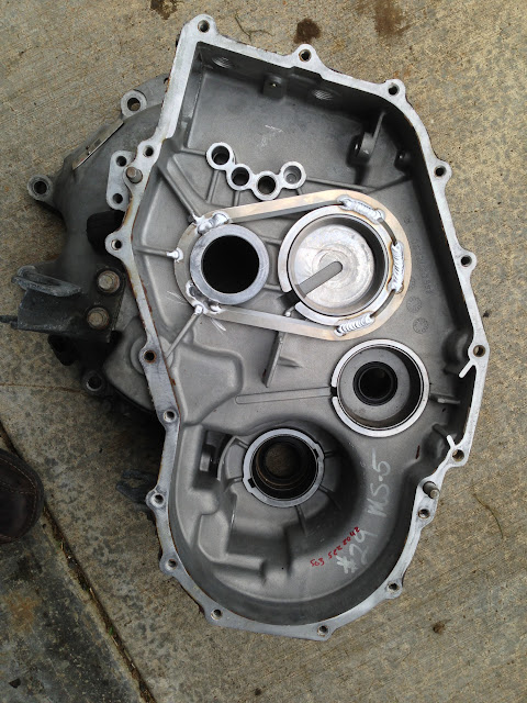

    Small update, as the Mrs has kept me Honeydoing the past three days. Damn garden!
    Got her welded up
    Fuel pump hanger is ready for assembly, and install. I had to weld the feed, and nut, O-ring, and epoxy the return. No room for welding between them.
    i had mine welded in the other way around. Mine has the beveled edge down.
    Denso Supra fuel pump, RC 750cc fuel injectors, AEM Fuel pressure regulator,

    Pics on Pampena's site have it installed with the bevel down.
    1995 Dodge Stealth R/T Turbo
    Mods: DR750s, BC Sportsman rods, Ross pistons, ACT HD 6 puck clutch, 5 speed transmission, 300M output shaft, Broomfield racing billet transfer case housings, Spectre air filter, GM 3.75" MAF w/translator, DN Pre-turbo pipes, Pampena/CX Racing dual core FMIC, M2 Performance turbo-back exhaust, Walbro 450lph E85 pump, SXPerformance fuel filter, stainless fuel feed lines, EK2 Mfg fuel rails, SXPerformance AFPR, 1000cc Bosch injectors, 99 VR4 replica ECU w/ Chrome for tuning, Kenne Bell Boost-a-Spark, Blitz SBC i-D boost controller, IPS oil cooler, Intrax springs on KYB GR2 struts, Enkei Kojin 18X9.5 +30, Nexen N3000s, 99 front end, carbon fiber steering wheel, Pioneer AVH-X2600BT, JL C2 6.5" and 6"x9" speakers, free 4 channel amp for subs (LOL), twin Alpine 10" type E subs.

    coop has the brace on the rite way, the beveled edge is there to create a "valley" so that when its welded it has more material connecting it and is stronger

    Taken from pampenamotorsports.com

    I guess they face it down for a reason, being they have more experience with this than i do. I thought that the beveled edge served the same purpose as chamfering pipes/tubes before welding to ensure the weld penetrates properly.

    The chamfer is probably there because when the brace is put on and it sits all the way down on the case, the case is not a 90* angle where it holds the bearing. It's rounded. So I'm sure it's chamfered so it can sit flush if need be. Because Bill got it welded up off the case for oil flow, it won't make a difference. I'm not sayin lifting it off the case is smart/not smart just that in this situation it shouldn't make a difference on which side the chamfer is on
